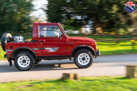

The aim behind Lil Red, James' SJ, was to restore it to factory condition. With the numbers of SJs declining rapidly and many "upgraded" into rough and ready off-roaders, it seems only right to preserve one in original specification without any modifications.
So, having passed its MOT in August, the plans have been firming up to get it restored.
