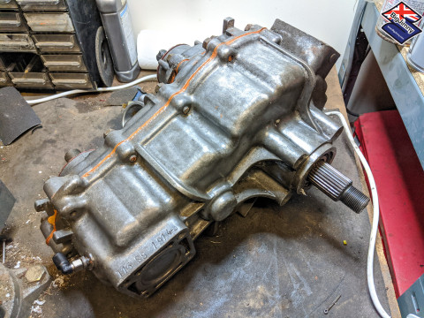

This three part article covers my building of a RockLobster 6.5:1 transfer box. The article parts are:
  • Part 1 - Dis-assembly (see HERE)
  • Part 2 - Building the gears (HERE)
  • Part 3 - Re-assembly (this part)

Finished!
4WD switch
Put in the ball bearing and then re-fit the 4WD switch. Stand back and admire your work.
