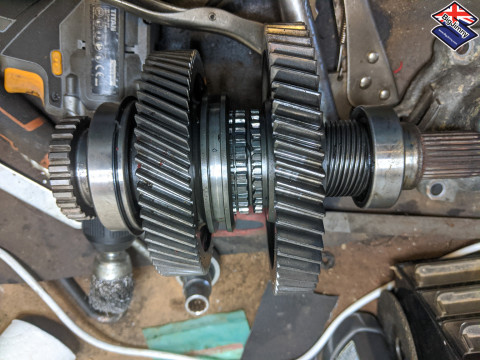

Original Output shaft
The picture to the left shows the full original Output shaft.
Starting at the "front" end of the shaft, remove the circlip and the Clutch ring. This ring should pull off but may need a couple of taps to help it along.
Removing the Output Gear (High)
Bearing removal
With the clutch removed you can get a set of pullers onto the larger bearing. The Trail Gear instructions show the gear being hammered off by trapping it between two metal bars and hammering the shaft, in my opinion a proper puller is the best option.
With the bearing removed you can lift the gear out as well as the needle bearing and clutch selector sleeve.

The finished item!
