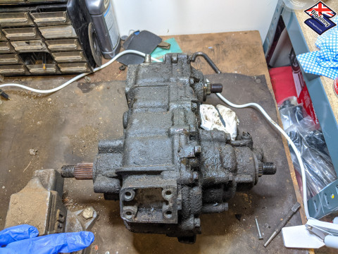

SJ413 Transfer box
​Starting point is an SJ Transfer box, any variant EXCEPT the early 410 will do. Here it is already stripped of the flanges and shifter stick (make sure you get both if you are buying one!). Along the left hand edge you can see at the top end the square edge of the PTO moulding and halfway along the bump for the Counter Shaft which help identify it as a suitable box.
