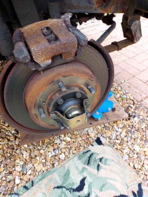

Samurai Front Calipers and Pads was created by tomcat
05 Sep 2023 05:12 #250670
Replied by yakuza on topic Samurai Front Calipers and Pads
My SJ's have all had the same caliper. Also the same calipers as my 05 Jimny had. Actually my Jimny from 05 had a caliper hanger from an 85 SJ as it had less rust. Before it got the vented discs.
There might be differences I have not discovered or changes between markets though.
Nice carpet, your knees must love it.
(mine hates gravel and concrete)
05 Sep 2023 07:20 #250672
by tomcat
Replied by tomcat on topic Samurai Front Calipers and Pads
Yakusa
Thank you for your comments. Appreciated.
The carpet strip serves in many ways and my knees do not suffer as much!!
