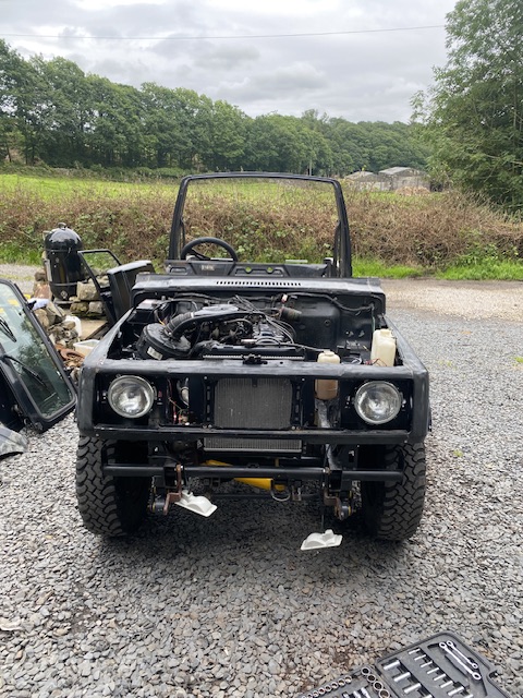

Working on paint prep on the Sami… so she’s all apart again… getting closer but we have a new behaviour. Now she doesn’t want to run. Turn the key and we get a rapid fire click click then sometimes silence.
Quick Google suggested ignition switch. So I hunted around and found a new one from India that came with the car.
Quick fiddle and it’s in. And we get clicky clicky no start again… what’s going on then? I can trace it out with time but I could do with an instant answer if anyone knows where to look!
Clicky clicky no starty was created by lesgrandepotato

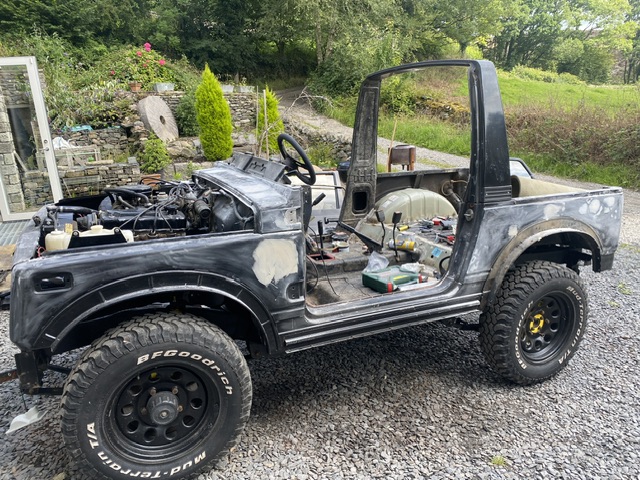

The mystery thickens! I’ve been chasing this issue about a while now. Sometimes it’s fine. Sometimes it clicks. Sometimes it just sends the whole car dead. No power anywhere.
Then after a period of time in seconds to mins she’ll just light up again….
So I’ve changed out the ignition switch to a new one. I’ve taken the starter out and bench tested it. All good.
I’ve tried tickling the starter in the car with power to the start connection. Nothing. No clicks, no pops. Not a sausage.
I think the starter or solenoid are the problem. But I don’t see why. I guess it could be the wrong unit? Are there different models? I guess the solenoid only works in some positions?
Any sage advice before I spring £70 on a new starter?
