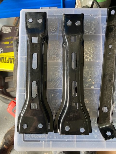

Picture 2 are the inner wing braces

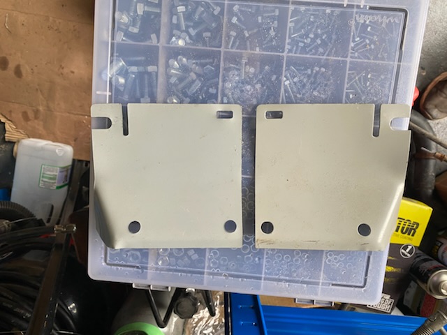

Picture 4 are the panels inside the rear of the front wings.

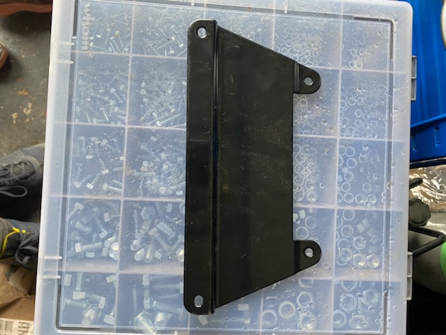

I wondered if pic one could be a brace from the back of the grill area? Between the two bolt in panels?

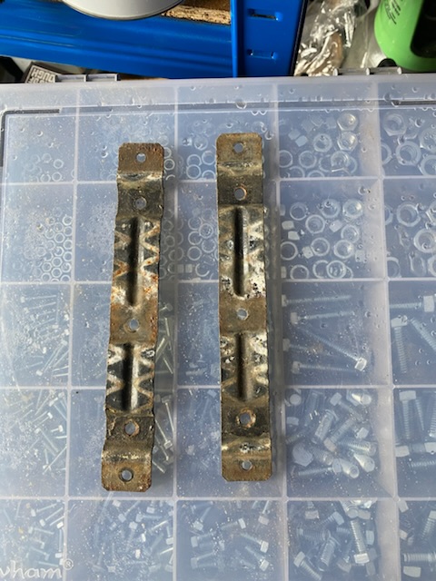

We’ve got a soft top if that helps with clues? Picture 5 could be some sort of tie down loop for the hood?

picture 5 could be brackets for fuel line and brake line inside the frame rail?

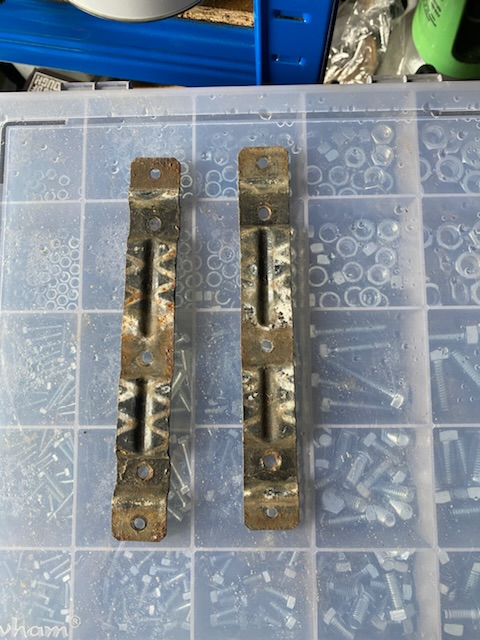

it bothers me very much that I do not recognice that part or the one in the third picture.
One and two is the brace for the front plate, the thin angled ones from fender to the front grille frame. and picture one like on Martins pictures behind the grille.
And the grey ones in picture four is covering the gap between the fender and the firewall where the fender attach to the firewall.
Could number three be something inside / behind the dash?

Number five hold the mesh to the inside of the late model grill…
That just leaves number three. It’s a really sturdy panel. I’ve been trying to align it to all sorts of stuff.
No luck as of yet
No luck as of yet
