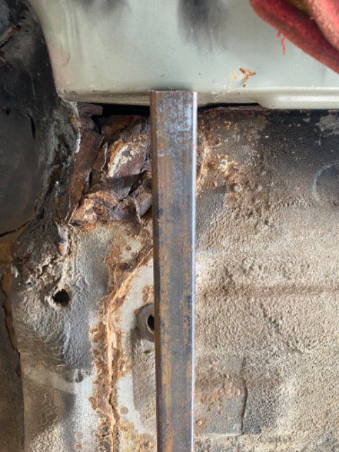

I’m expecting to do a bit of panel fettling. The two panels above and below the grill are horrendous. Wings look ok.
The floor will be fine it’s a reasonable fit. Bit of a head scratcher in the sills have been replaced over the old ones in places. This and a slightly under size repair panel could be fun. Will probably just section it and leave the original in place. The location accuracy for the body mounts has plenty of tolerance. Could easily be 3/5 mm off and no real effect.

23 Apr 2023 08:29 #248770
by lesgrandepotato
Replied by lesgrandepotato on topic New SJ owner - couple of q’s
Getting stuck into the arch repair today hopefully. It’s getting a bit involved… I’ll feel better once it’s all cleco’d in!
- lesgrandepotato
- Elite Member
- Posts: 189
- Thank you received: 57
23 Apr 2023 16:47 #248795
by lesgrandepotato
Bit of progress today. Took the small problem. Cut back until I could find something worth welding too.
Then pulled the new tin in. I can see why SJ’s have been scrapped for this job! It’s not easy. Lots of intersecting panels and once it’s all been bodged up not much reference to make sense of.
Still we are making a tidy runner for trialling and the odd classic show not a show pony!!
