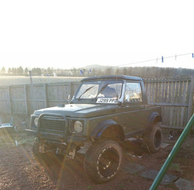

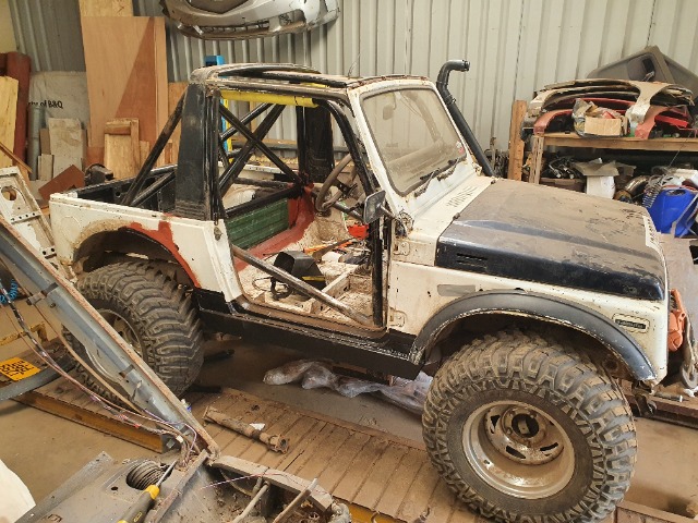

How she started
How she was looking till last week

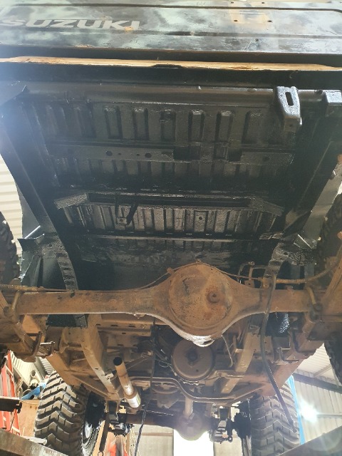

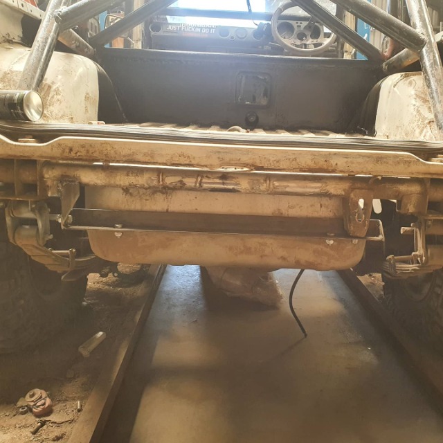

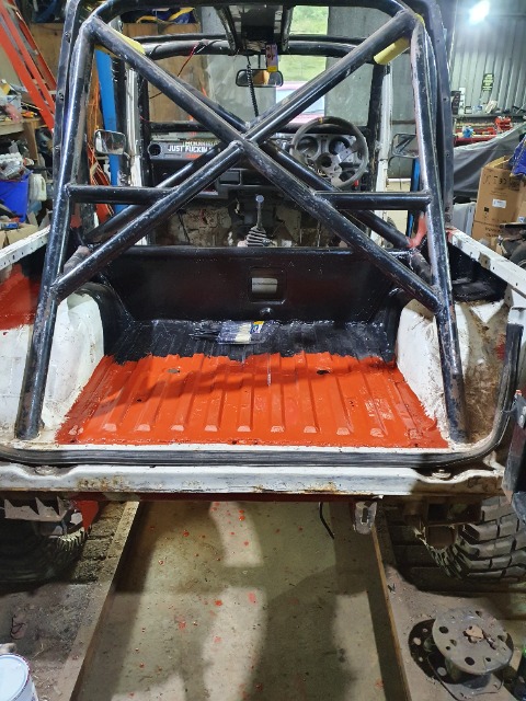

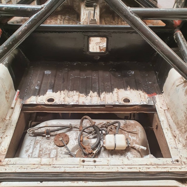

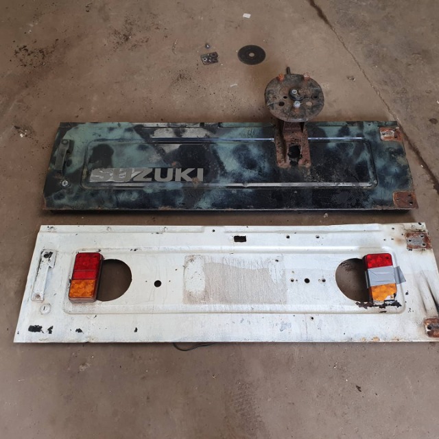

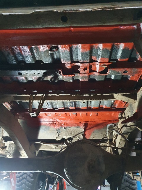

Thanks for the positive feedback! Done quite abit since my last post. First I did some welding to the back including adding a short bulk head in behind the seats.

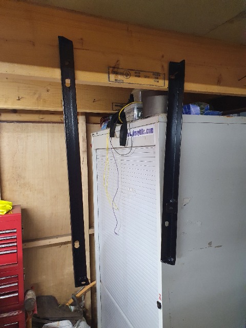

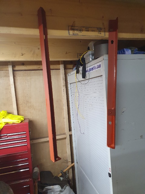

This was also started as the vitara fuel tank was just cut into the floor behind the seats. At the time I was less worried but started thinking what if it ever did go up. So now it fitsunderneath with some slight modifications to the factory mounts and some new support bars.

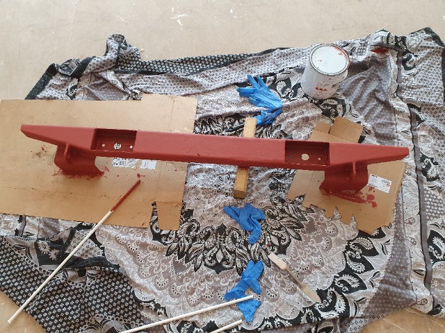

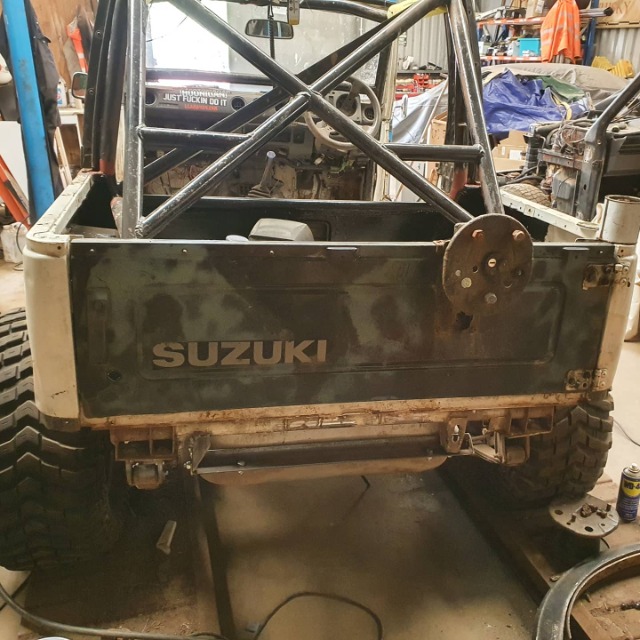

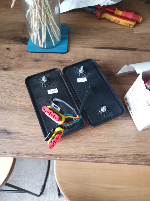

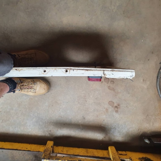

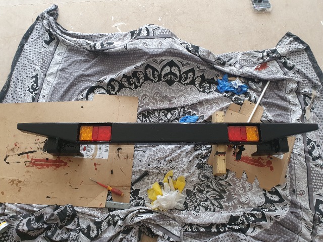

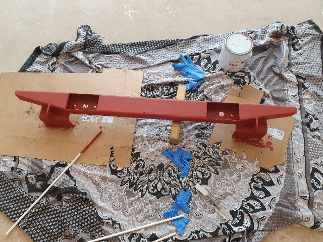

Changed my Tailgate over aswell as it was bent and the previous owner had cut two holes in it for the tails. This ment redoing my bumper to take the lights. Also decided to add some waterproof connectors at the same time.
