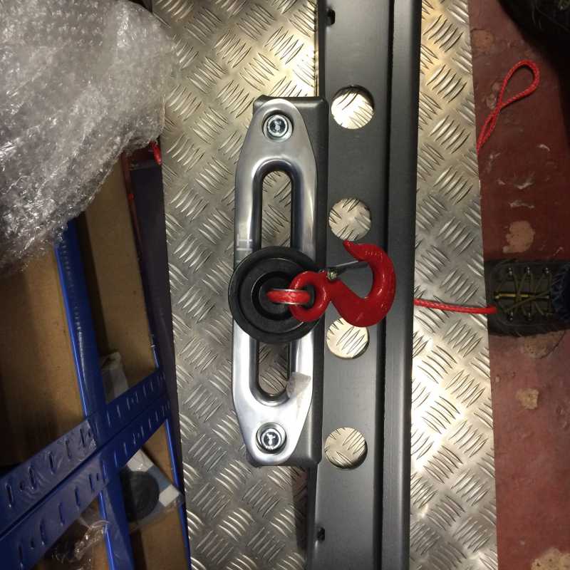

Front winch mount from AFN in Portugal, via West Coast Offroad who imported it for me...
That will go behind the front bumper very much like a JimnyBits winch mount, like this -
Only I want to keep my lower grill -
As I'm only using a little 4,500lb winch, which will be plenty as this one won't be wondering offroad too much...
It only came with a tiny fairlead for an ATV, so I've got a better one ready -
