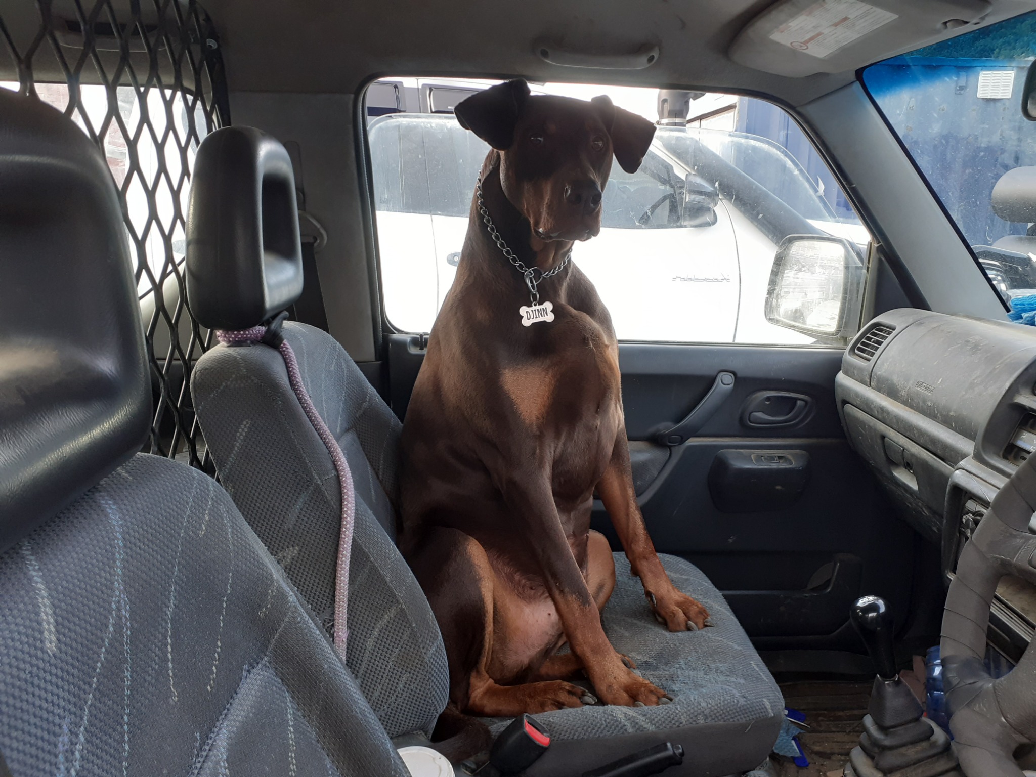

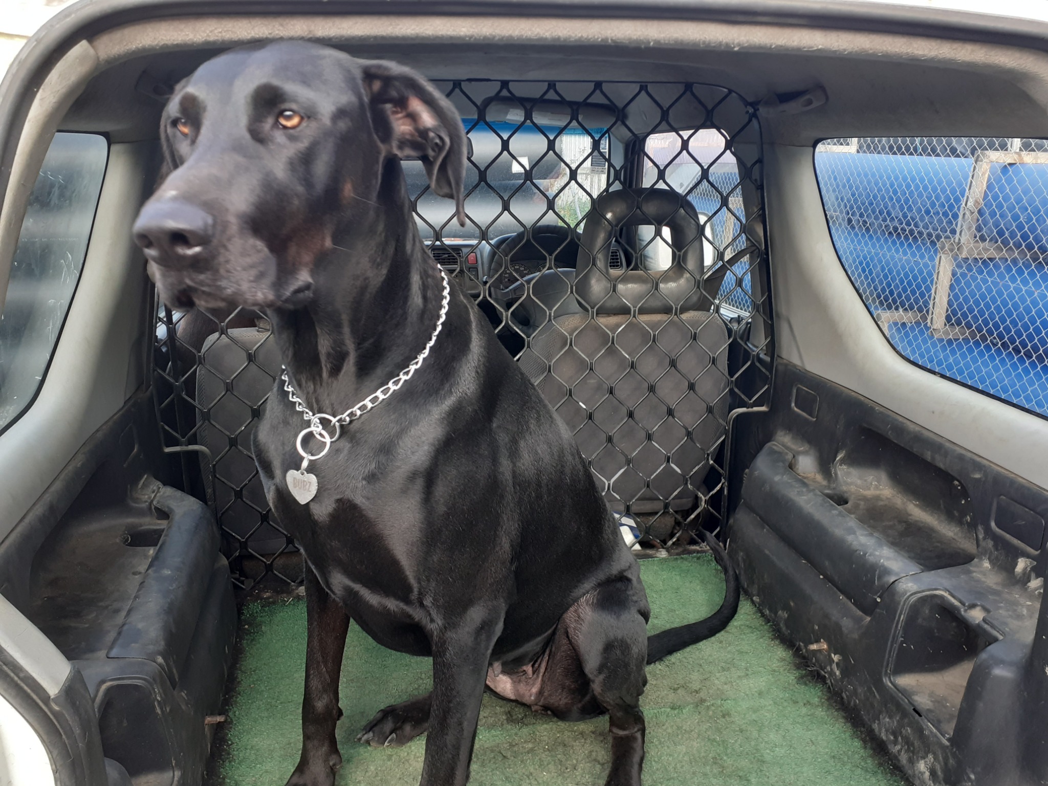

Dogmobile conversion.
I made up an aluminiumbar-stock profile that matches the inside of the Jimny interior.
Bottom rail bolts into the four boltholes the flip-up seatpans normally bolt into.
Top of the frame braces back to the rear ceiling handgrip boltholes.
Security mesh was trimmed to match the profile and tig welded in.
Base is 18mm ply cut to tightly match the floor profile.
Hinged in the middle to still allow access to the toolbay, front half of the floor is secured by the same seat-pan bolting points the mesh-frame is secured by.
Topped with astro-turf.
Whole thing is rock solid by the time it is attached and bolted in.
Trusty old faithful red-dog in the front.
Sneaky eaty wee Miss who has all the self restraint of Yogi-Bear in the back.
