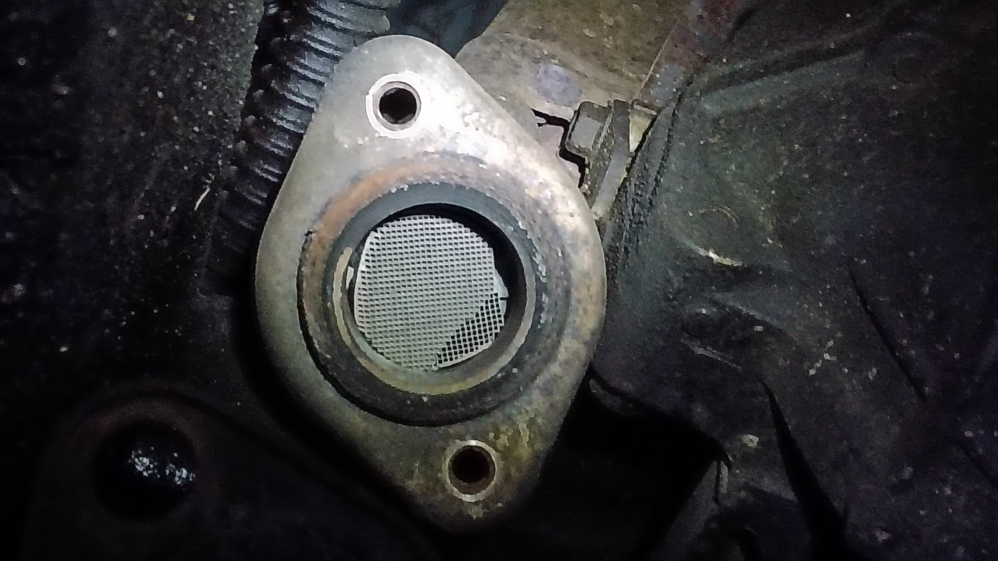

Opened the exhaust between the catalytic converters and was greeted with a solid chunk of cat junk. I then used a rod to smash out any remaining fillings that was visible from the first cat.
I inspected the section with the second cat from both ends. No sign of debris there, also no rattles.
Put the exhaust back together and went for a test drive. Much better but not perfect, I need to replace the second cat too.
