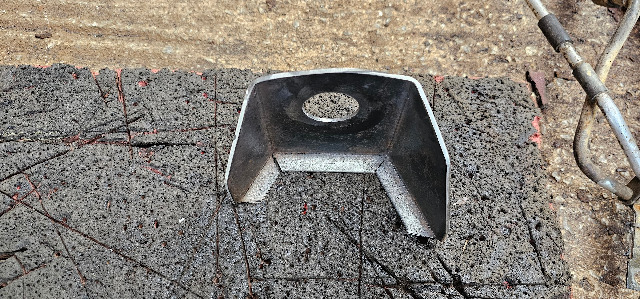

Replied by MigCooper on topic New Project
Do you have a picture of how the rubber sat back in on that mount...
I started just replacing the whole mounting to simplify things on repairs.
I was assuming he was referring to real galvanising TBH, I didn't know "spray on" galvanising was possible, but in this context that makes more sense.
It was the spray on one, not the "real" one
Regarding the wax, i am not sure what type is it, the idea is to put it inside all the chassis legs and holes to prevent rust from the insideSpray on Galvanizing is Just one step up from American powder coating when it comes to rust prevention in my book.
It also says some sort of wax wich is good and the combo is very good.
Real Galvanizing is dipping the complete part in heated acid and then heated zinc.
Wich in some cases will warp a car frame.
I got my trailer frame dip galvanized, wich went fine because I boxed it off to prevent the warping. And I was prepared it might get warped.
