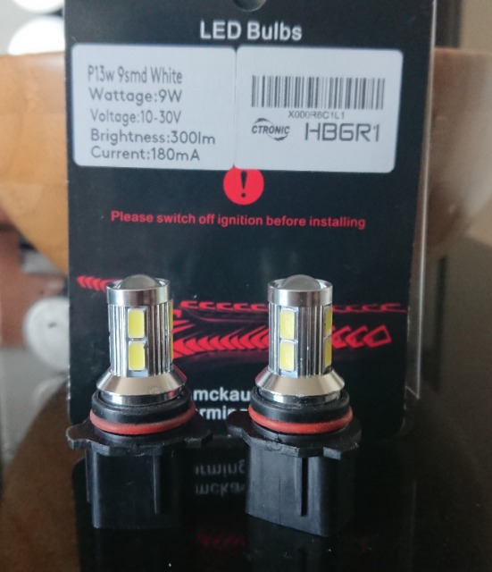

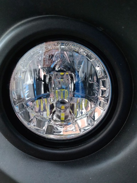

I've given up with them for now and reverted back to halogens. Mine had only one of the lugs in properly so it was lucky they hadn't fallen out completely. Despite an hour of faffing around at lunch today they still wouldn't fit properly. The bevelled edge at the base of the LEDs looks to be fouling on the surrounding housing and not allowing all the lugs to move behind where they slide. They're both scuffed on that bevel at the top edge.
My next option is to take the whole lens unit out and have a go at fitting them where I can better see what I'm doing. I'd got a lit mirror in there so I know I was putting the right lugs in the right place but I just couldn't get it so it would turn smoothly. In contrast, the halogen bulbs went in and turned with next to no effort at all.

30 Mar 2019 07:20 - 30 Mar 2019 07:23 #205281
by mikeyw85
Replied by mikeyw85 on topic Gadget's 2019 hearing aid SZ5
I think lot's of the LED ones are too wide to fit. The hole in chrome reflector housing is too small for them to go all the way in.
On attached image... left one should fit, right one too wide. look almost identical, but i think the bottom of the chrome bit is too wide on right one. it's fractions but seems to make a difference.

30 Mar 2019 11:30 - 30 Mar 2019 11:31 #205292
by Hanslow
Replied by Hanslow on topic Gadget's 2019 hearing aid SZ5
Thanks mikey and apologies gadget for the slight thread derailment. I might need to hang up my spanners if I can't handle fitment of two bulbs
I've attached a pic of the ones I have. I don't know if you can see, but on the leading edge of the angled silver bit, just above the recess, there's a scuff where it's been catching on something. That could be my hamfistedness, but using an inspection mirror I made sure the lugs were correctly lined up so expected to be able to just push and turn but it won't seemingly fully push in all the way. Is there a knack to approaching it in at an angle and then straightening up?
I managed to fit the halogens back without issue so I'm not a complete imbecile
Last edit: 30 Mar 2019 11:31 by Hanslow. Reason: Added attachment, I am a complete imbecile
30 Mar 2019 13:11 - 30 Mar 2019 13:11 #205295
by Hanslow
They're in
After much toing and froing and thinking "Surely this can't be right", I filed down the tapered overhang such that the initial vertical metal that meets with the plastic housing is now more of a straight cylinder up to the taper and the taper from the actual edge without any lip (you can still see the lip in the pics).
I've no idea why mine weren't straightforward like others, maybe just manufacturing tolerances, but at least they're in now
I'd say about 0.5mm came off all round, maybe a bit less, so not much difference.
