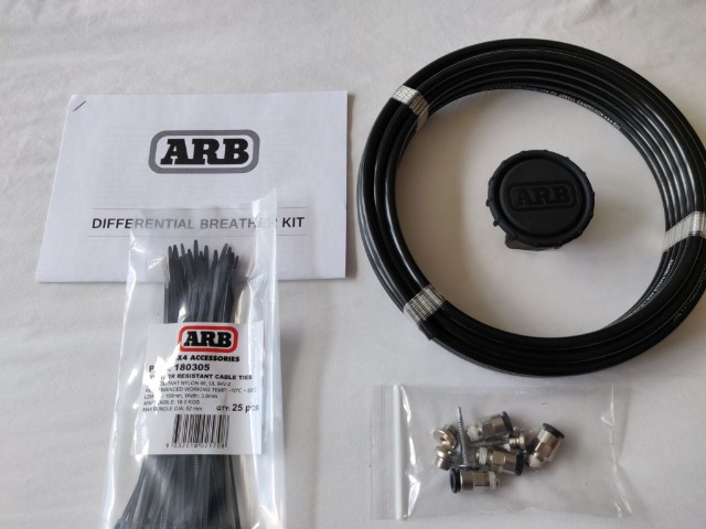

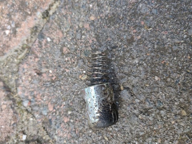

I got distracted while saving for a MIG welder and bought myself a diff breather kit
The kit comes with 6mm ID tube, however the diff breather itself has a 14mm-ish nipple, so looks like garden-hose + reducer to connect the ARB hose. Spent a bit of time wondering how to get the spring loaded cover off.
Some advice on facebook and violence with pliers later, off it pops.
Fingers crossed the install should be straightforward, but will leave that till the weekend

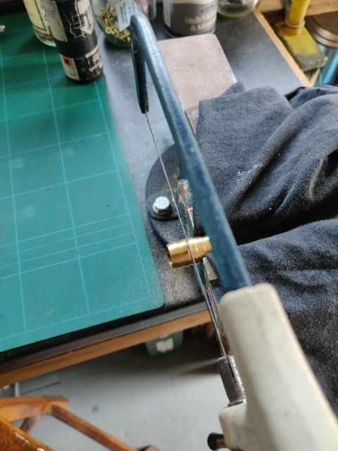

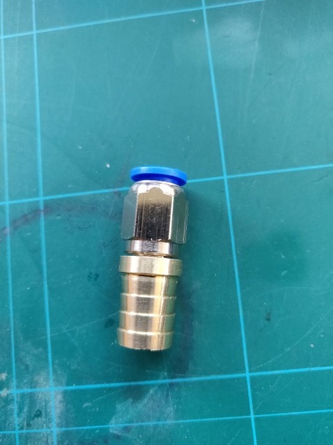

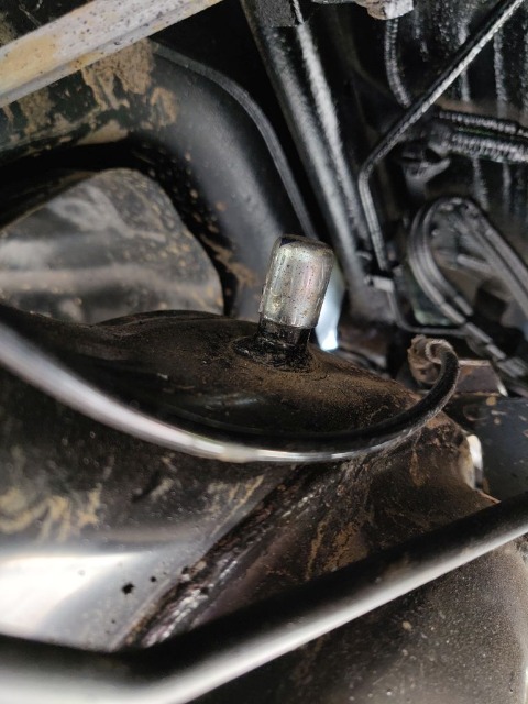

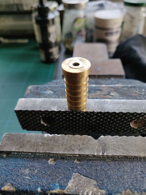

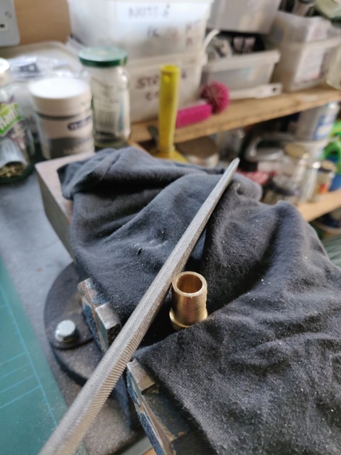

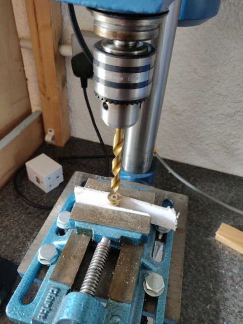

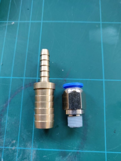

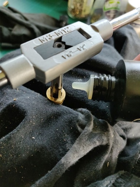

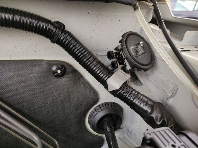

Finally got round to fitting the breather kit at the weekend, but not happy with how it's gone. My cunning plan of having a short piece of hosepipe clamped to the breather and using a 13mm to 6mm adapter to then connect to the ARB-supplied tubing sounded great in principle, but there's limited space available above both axles and kinked tubing has been a problem.

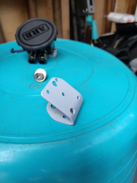

For the manifold I've seen others drill holes in the bulkhead and fix it with screws, but that didn't appeal, soI spent ages modifying a bracket to make use of an existing hole in the corner of the engine bay. Was fairly chuffed with myself until I spotted that Soeley had simply cable tied his in place, duh, why didn't I think of that! :pinch:

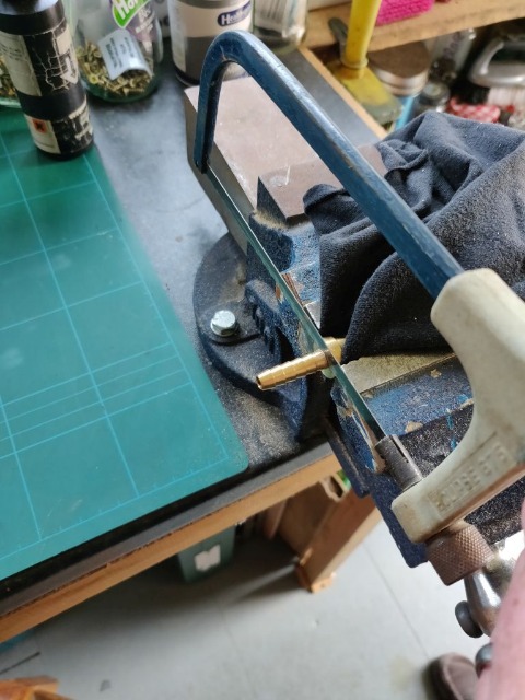

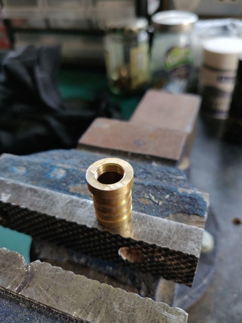

I'm going to redo the fittings this weekend and taking another of Soeley's ideas, I've cut down the 13mm to 6mm adapters, then drilled and tapped them to accept 1/8" BSP to 8mm push fittings. That should hopefully avoid fouling on anything above the axles.
I've also bought some new tubing as the ARB stuff kinked far to easily for my liking. Still 8mm OD, but .5mm thicker sidewall and red for added bling points.
So pics of my faffing to date below, install attempt #2 due this weekend!
DIY bracket thing:
Lets me mount the manifold here:
Time to make 2 become 1 #spiceupyourlife:
Chop off the pointy bit:
Shorten the fat end:
Drill a new hole:
Tap hole:
Nice short fitting:
DIY bracket thing:
Drill a new hole:
Tap hole:
Nice short fitting:

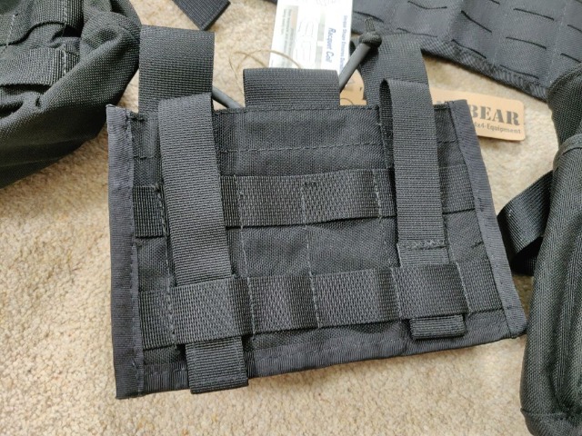

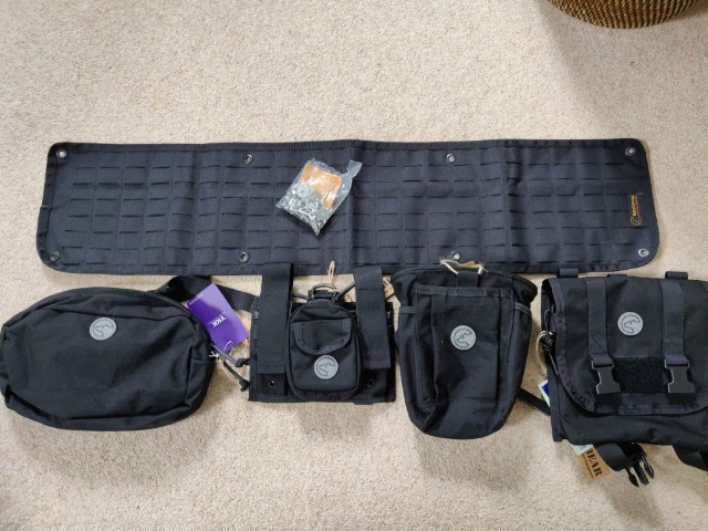

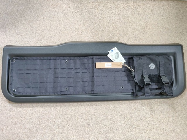

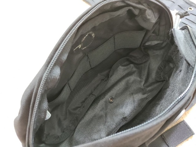

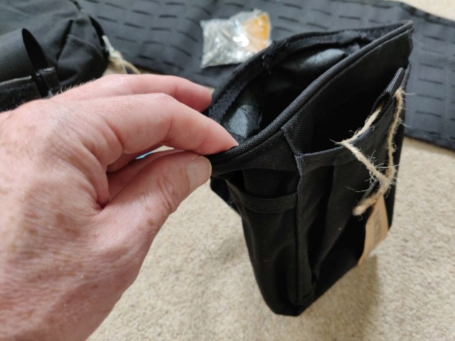

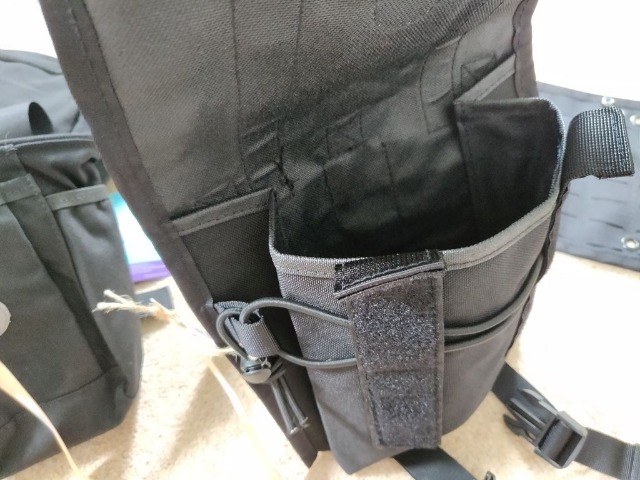

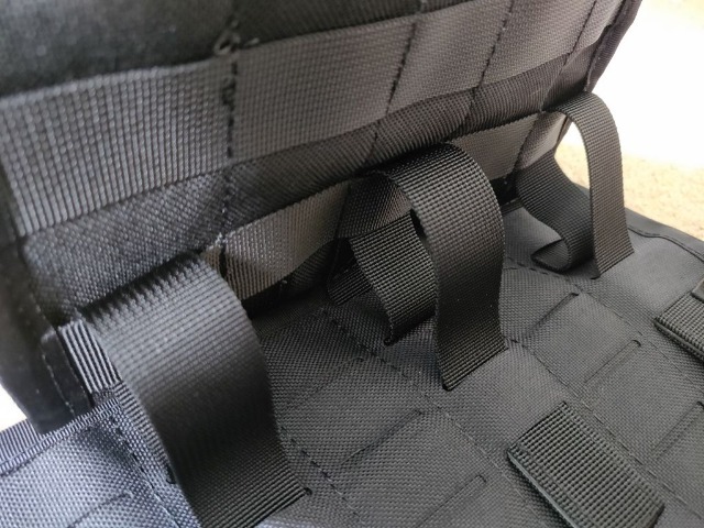

My MOLLE Tailgate organiser from Nakatenenga arrived today and seems good so far. It came with four pouches (a tear-off first aid pouch should have been included but was missing - the company responded to my email quickly and will be sending the forgotten item separately).
The panel itself is nylon with laser-cut MOLLE compatible webbing slots. The use of MOLLE means that there's a vast array of military/tactical/airsoft/paintball pouches and gizmos that can be weaved onto the panel, you're not limited to the supplied pouches.

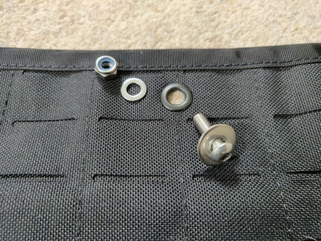

The panel attaches to the rear door trim via 8 hexbolts, so you'll need to remove the panel and drill some holes. They supply a good quality bunch of fittings. 12 dome head hexbolts with large face washers, smaller backing washers and nylock nuts. The bolts go through metal eyelets in the panel.

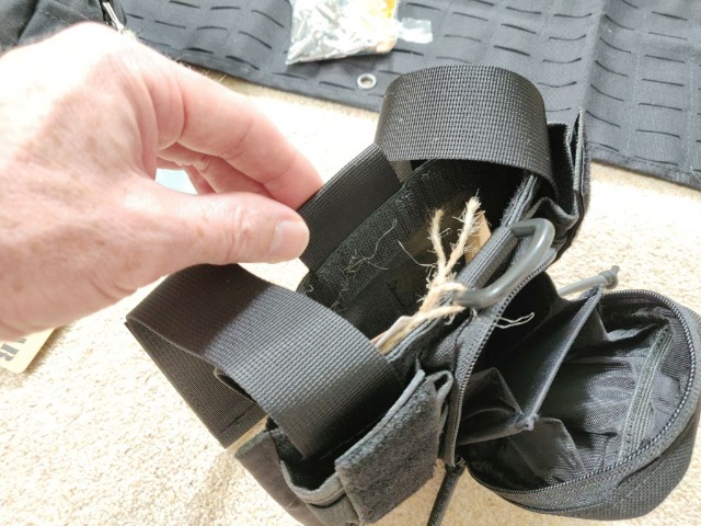

The pouches supplied are:
1 x zippered pouch, approx 250x170mm with elasticated loops inside. I'll probably use this for tools.
1 x multicompartment pouch. Has a small concertina section (approx 120x100mm) with velcro closure pocket on front. At each side are effectively gun mag pouches, with velcro retaining straps. At the back is a flat velcro sealed pocket about the size of a passport. Not sure what I'm going to do with this one.
1 x open dump pouch. Has small side pockets for narrow items and a velcro sealed front pocket. Main pocket is approx 210 deep by 140 diameter. I'll probably leave this empty and use for wine bottle storage after a trip to the shops!
1 x clip & velcro sealed pouch approx 200x210mm. Single compartment which can be shrunk by use of elastic shock cord.
If you've worked with MOLLE/PALS type webbing before, you'll know it can be a faff to weave pouches onto the panel, but the straps on these pouches seem better than most, with reinforced ends which slot through easily and can be folded back when complete to hide the loose ends.
