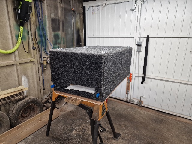

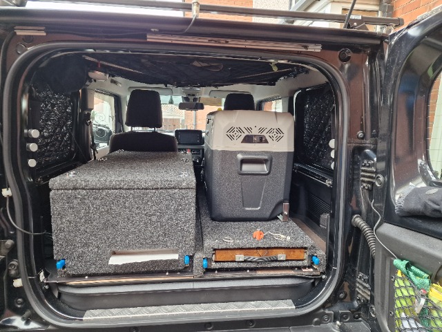

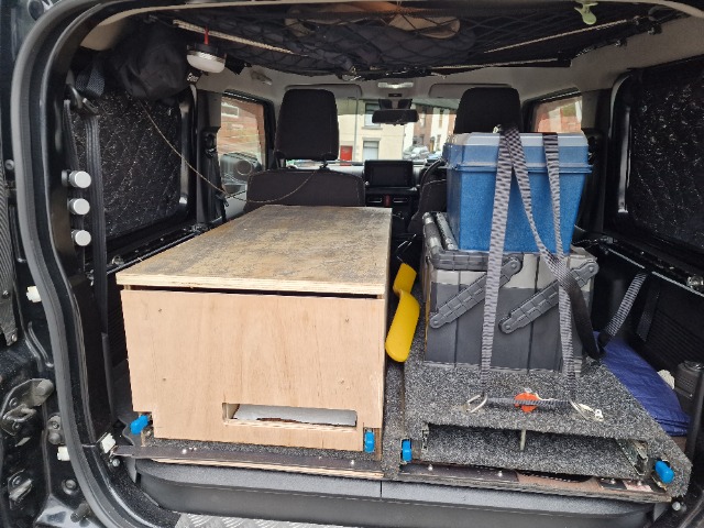

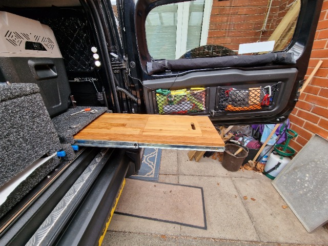

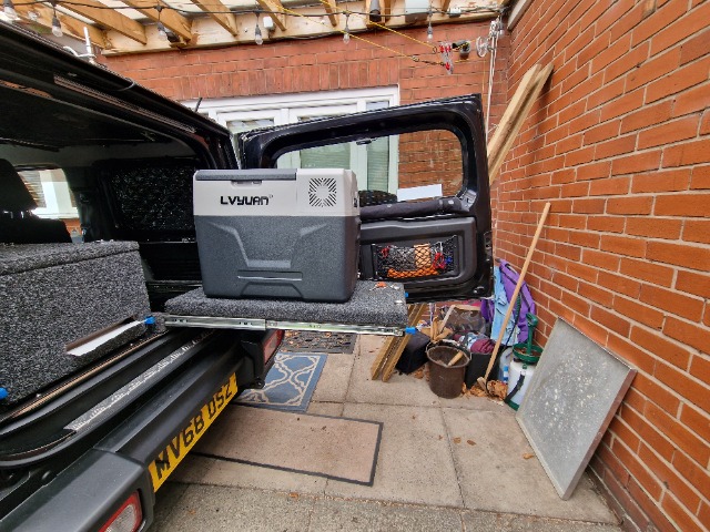

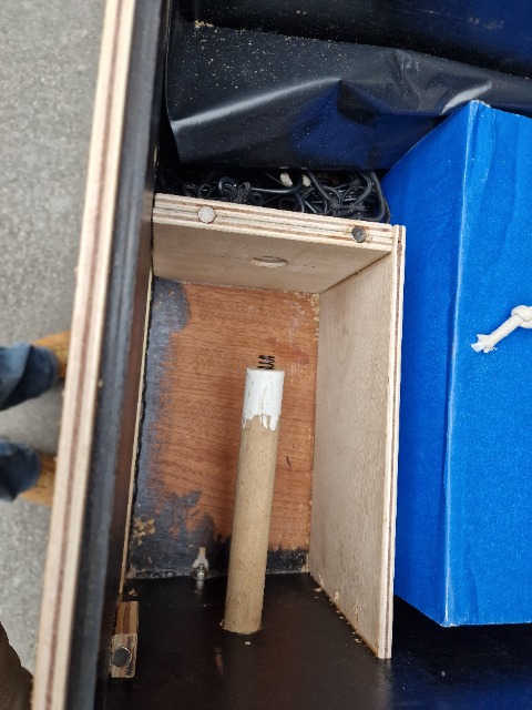

So, to carry on with the
Fridge Slide

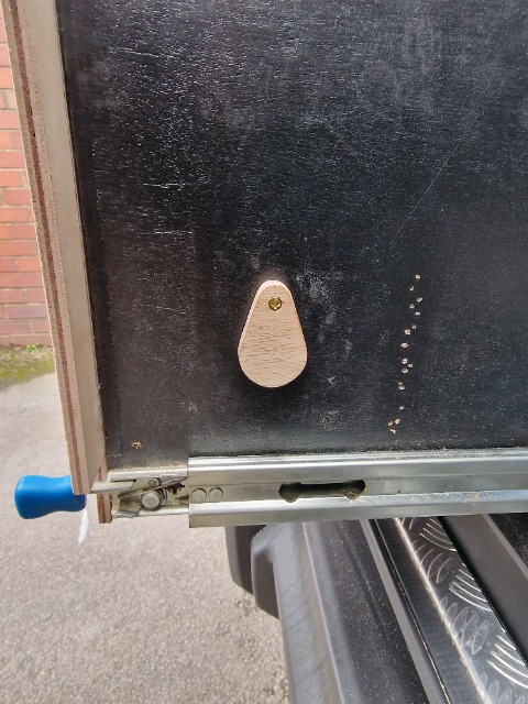

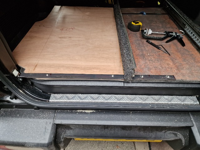

project, I have now completed the Pull Out Drawer.
I have adapted the fridge slide a bit more and cut 22" off the length of the drawer to fit in the Jimny.
Made a new base for the drawer to allow me to fasten it down the same as the slide.

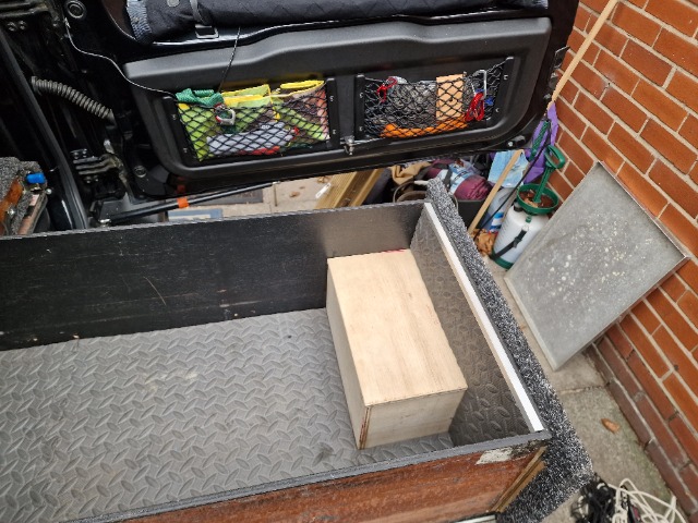

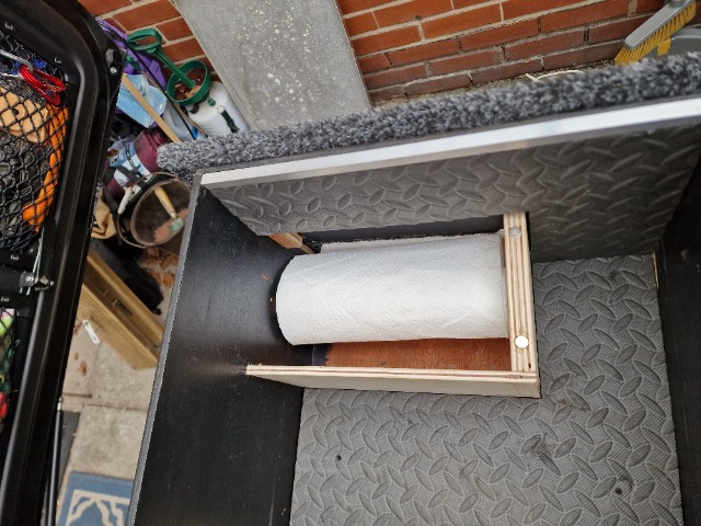

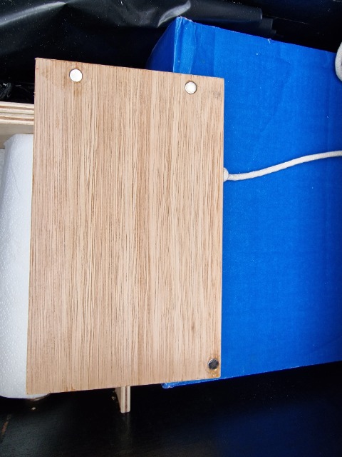

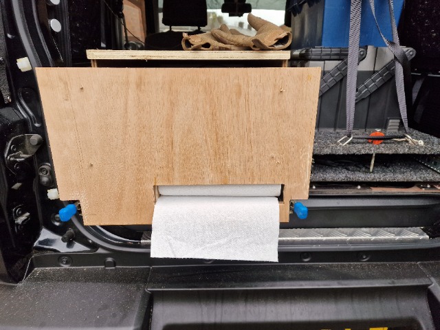

I decided to do away with the pull-out table in the drawer, one is enough. The gap gave me an idea for a kitchen towel slot.

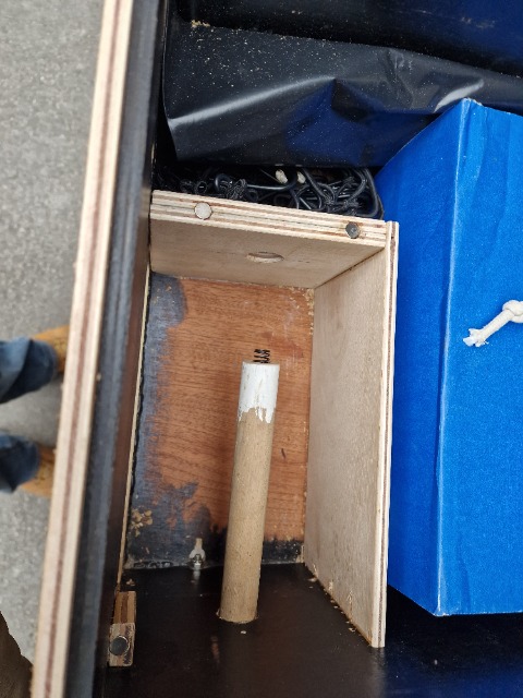

Boxed in on the inside.

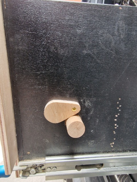

Side mounted, spring loaded spindle.
The lid is held in place with magnets.
Trial fit.

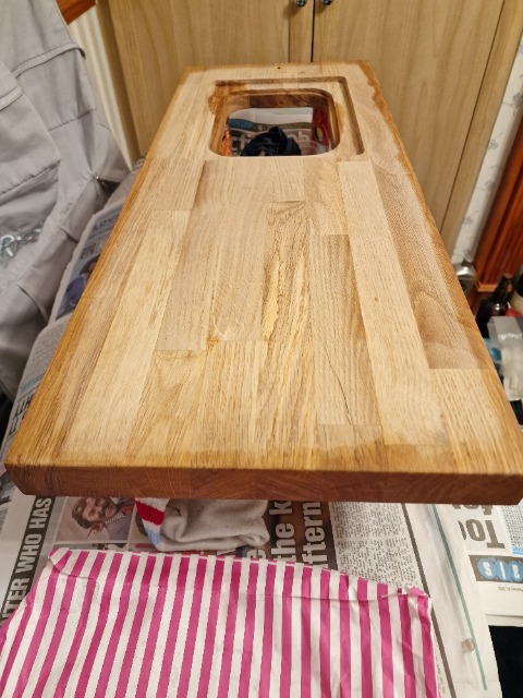

Table sanded down ready for oiling.

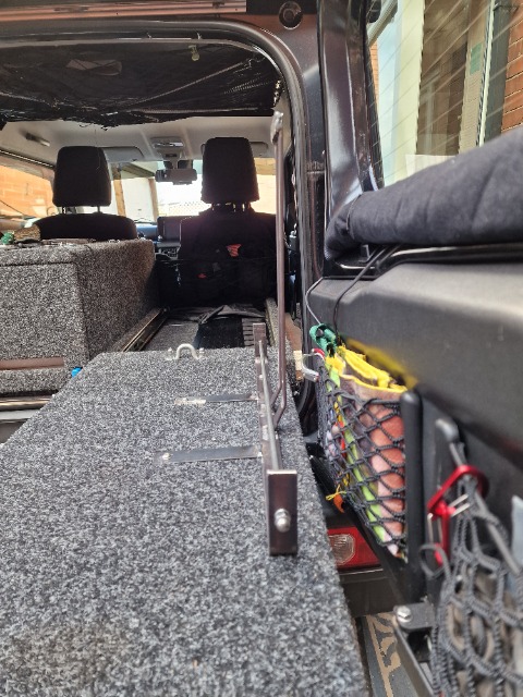

Managed to reuse all the carpet to recover the drawer housing.

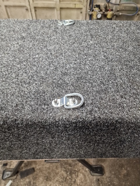

Added some tie down anchors to the top.

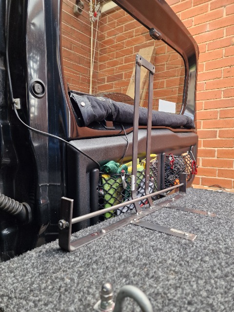

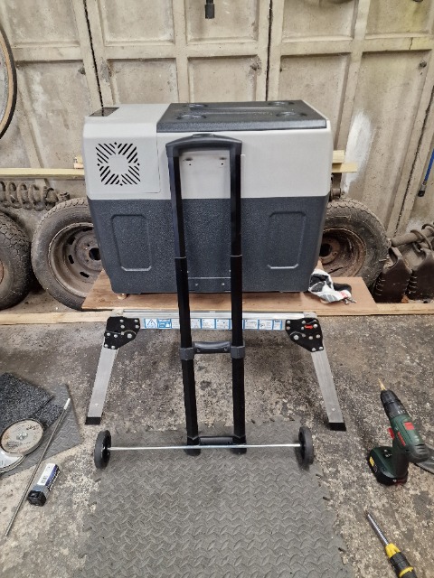

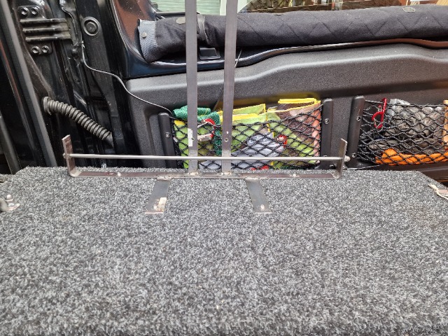

The wheels and handle can be removed from the fridge.
So I made a mount to bolt down and secures where the wheels and handle were.
Made a new axel with a thread at one end and dome nut loctite'd on the other.
A nut is welded to the other end of the mount.
All done, no fiddly strap to remove every time you want to open the fridge.

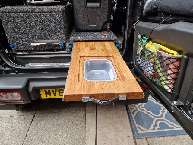

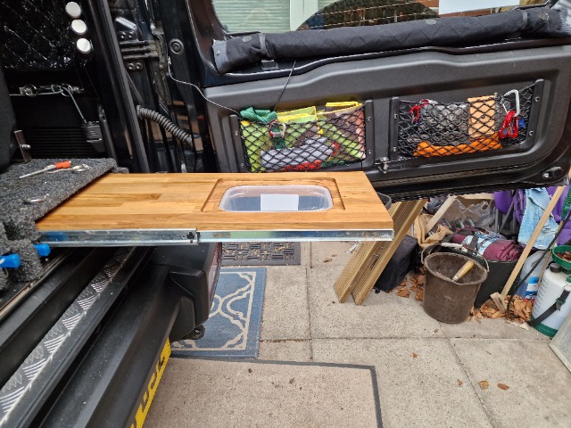

The bamboo chopping board is removable.
And you can drop in a small food container as a washing up bowl.

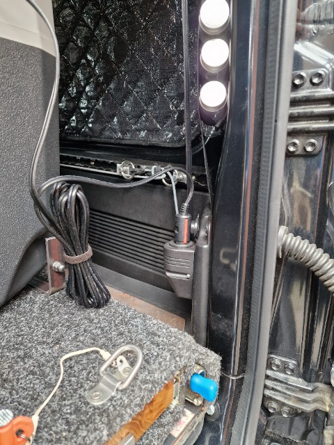

I also added a power socket to the drivers side for the fridge to keep the wires tidier.

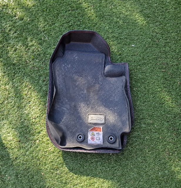

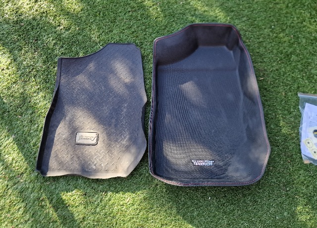

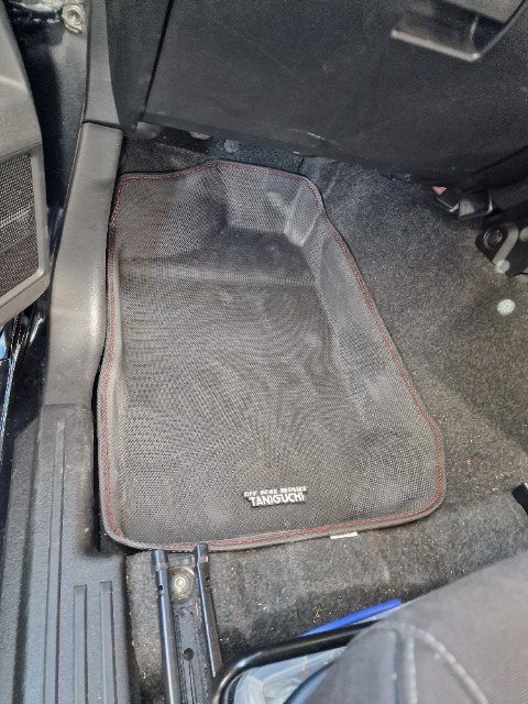

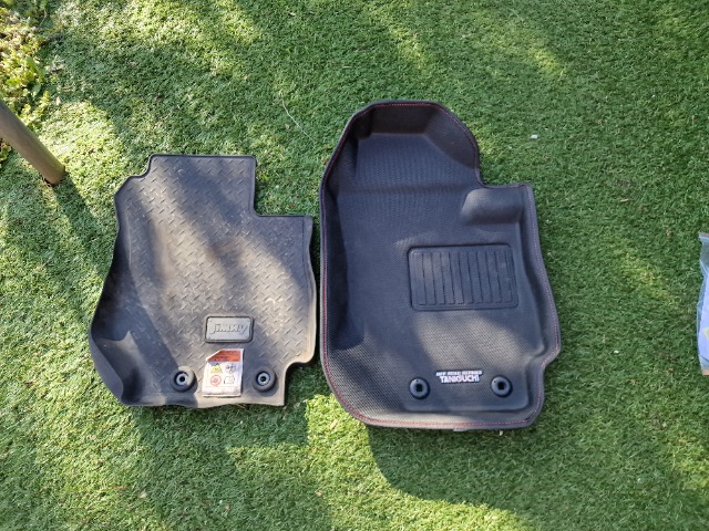

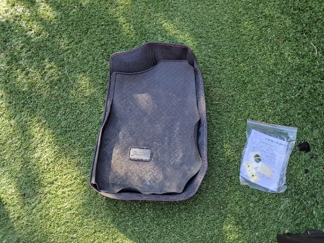

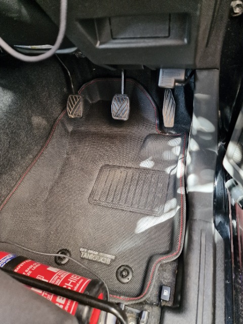

I have upgraded my front floor mats to some Taniguchi 3D mats. Much deeper sides and fit better than the OEM mats. The drivers side also covers more area under the pedals. Bought 2nd hand with only 100 miles usage.
