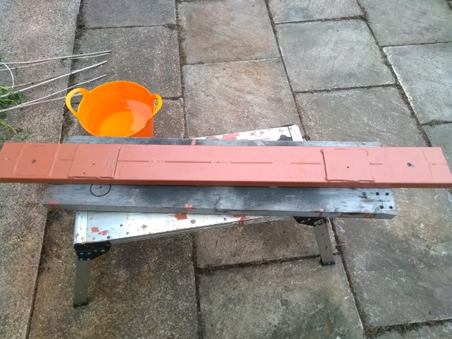

If the sills and front body mounts are ok, then its worth getting the rear welded up. I would have a serious poke about elsewhere to check if any more needs doing.
That part looks pretty easy to patch weld so shouldnt be a challenge for a good garage.

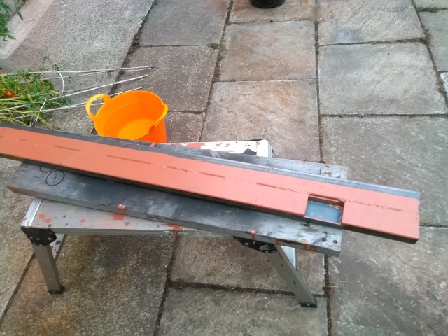

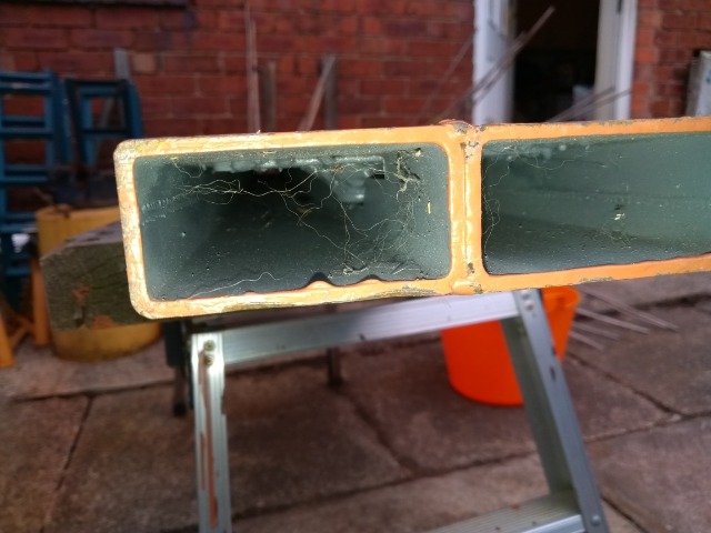

If incase you need to replace the rear body mounts
I have this lying around from a previous project I scrapped
Jack
Jack
