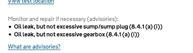

27 Nov 2018 17:54 #198239
Replied by Riccy on topic CAE's Daily Jim
Might be just the prop leaking? clean it up, go for a spin then see whats slimy :laugh:
You can change the prop by putting the rear onto ramps. This stops the gearbox oil pouring out all over you when you remove the prop
was a known baddie on the earlier VVTs (like mine
- Caelite
27 Nov 2018 18:52 #198245
by Caelite
Replied by Caelite on topic CAE's Daily Jim
To be honest I'd probably change the gearbox oil anyway. I doubt it has been done since the car left the factory. and year rear prop seal is what I meant to say.

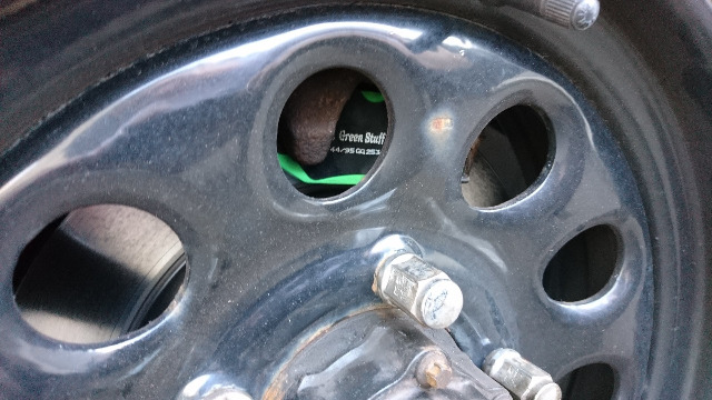

Well, haven't updated in a while, prop shaft oil seal was replaced, however something else has now sprung a leak further back, which I imagine must be the transfer case. Yet to be investigated. Finally gave in and gave the car to a garage today, I now have a new passenger side kingpin bearing, rebuilt driver side brake caliper, two new discs & some EBC green stuffs across the front axle. Got back from my holiday a couple of weeks ago to a siezed driver side front brake which just completely goosed it's pad & disc.
Hurt the ol' wallet but car feels fantastic.
