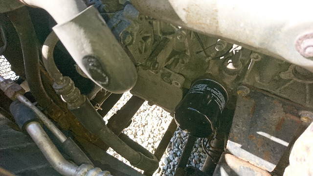

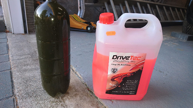

Service finished. Ended up doing the coolant too which I have been meaning to do since I bought the car as it looked in a sorry state, the first flush confirmed this
5 flushes later its totally clear and full of my chosen red stuff.
Oil again, was in a sorry state. I really question the validity of the claim from the dealer I bought the car off of that they serviced it themselves when it came in to them. The oil was in an awfully sludgy state, I believe it is much more likely it was last changed when the last stamp in the book was at, about 25k miles ago. That being said, new fully synth has done it a world of good, the pronounced VVT lift at 3500rpm appears to be back, and a small amount of top end tappet ticking has all but entirely disappeared.
Still on the to do list is my kingpin bearings, diff, tcase and gearbox oils and a very late aircon system refill.

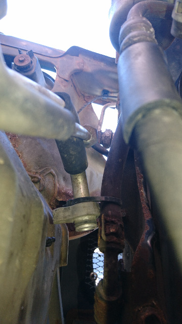

Right, I might be going a bit mad.
My Jimny has air con. Or at least there is a button on the dash that says A/C. It has never worked, it also never had made any noise or change in revs when the button is pressed. I had the system pressure tested and there is zero pressure.
Now this is the bit that is getting me, WHERE is the Jimny air con compressor? Conventional wisdom says its a clutched mechanical system (its old and Japanese, i doubt it'd be electric). Normally they sit on the aux belt below the power steering pump. I can't see mine, where I would expect an air compressor to be there is nothing but a blank bracket.
Am I looking in the wrong place, or has someone taken the AC pump off of this motor at some point and not put it back on?
Edit: Just looked again, yup, someones pikey'd my AC pump, traced the pipe down from the test valve and it leads down to absolutely nothing.
