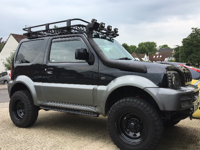

I do understand that, but I'm afraid of water leakage after "tampering" the OEM rails.
Given that the rails have a limited load limit of ~40kilos and the roof rack weights about 5 kilos now (with mounts and paint it will gain 1-2 more kilos), I would say that I'm having a safe 30kilos of load to carry.
In the end the purpose of the rack is to carry some light luggage when travelling and 99% of situations will just hold the roof lights/ledbar.

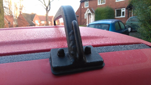

Ah no, the rails are held on by captive studs protruding up from the roof, there no path for water ingress.

As 11/60 says i have had no problems with water
Also if you actually removed one of the roof bars
You will see just how flimsy they are
