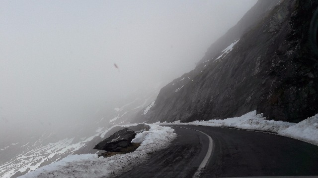

Few trips since I've got it, including the famous Transfagarasan:

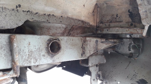

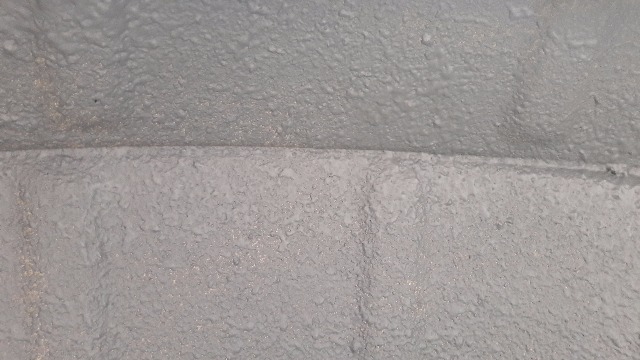

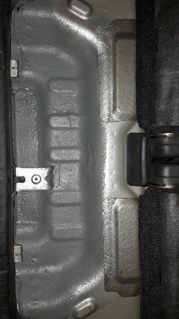

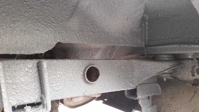

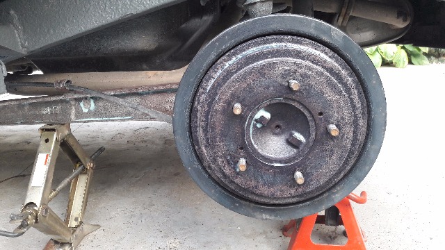

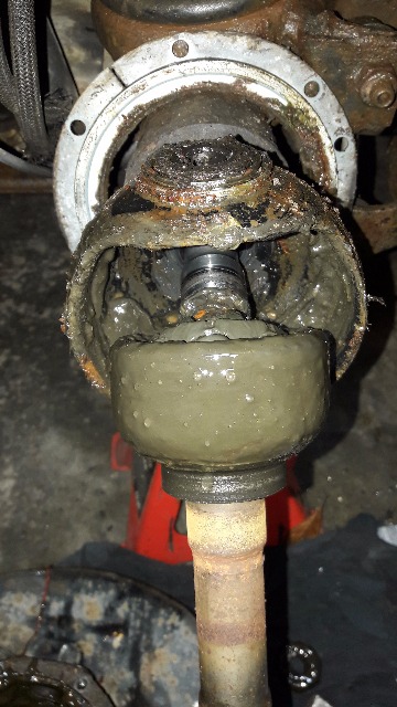

Additionally, I had to go through full service schedule, engine oil, gearbox, transfer case, diffs oil replacement, full vacuum circuit, solenoids, hubs, kingpins and last but not least, rust treatment, all DIY:
yes ... it's mud....
fixed on both wheels
rust removal and welding (only one small area) and treatment (Chelade) for areas with superficial oxidation:

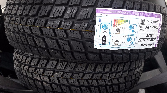

New winter tyres:

New winter tyres:

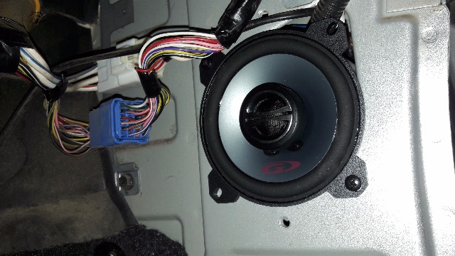

Replaced front speakers:

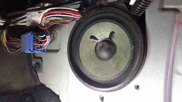

Fitted rear speakers:

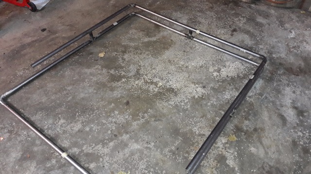

Started to build a rook rack (for some extra space if/when needed) - work in progress to find a way to install it without removing the rails:

The strongest and best way to mount that basket is to remove the rails and bolt it directly to the roof. It won't let you carry any more load up there but it will be a lot better than relying on the existing brittle plastic feet.
