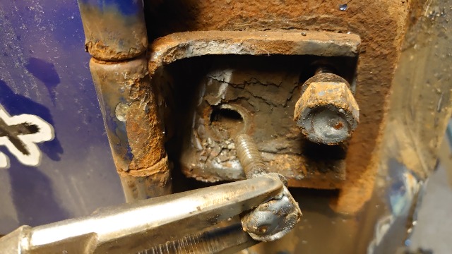

Grinding now. Happy that I just bought a cheap air grinder. Had to weld nuts on the stuck bolts, the head was so rusted the tools Just slipped.

Got the door off and cleaned up a bit.
Nice weather out and I have this 39 year old open top car so not more got done today.

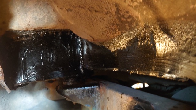

Got the welding done and as usual it was way more than it looked like at first glance.
Had a bit of trouble getting it MOT'ed as the rear brakes where weak. could not find anything apparently wrong with them but after cleaning and putting new pads and rubbing and lubing the cylinders it passed.
