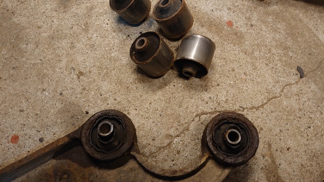

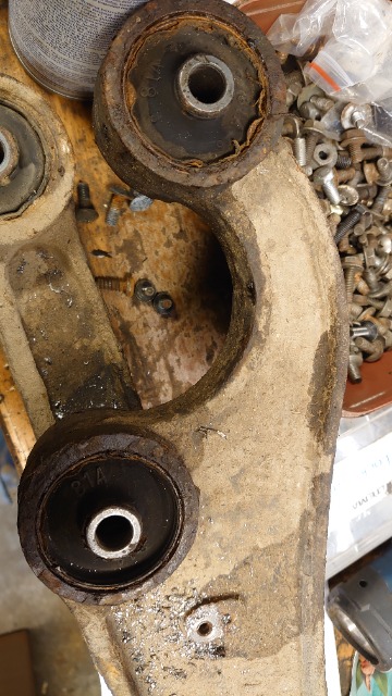

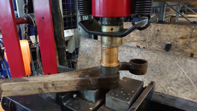

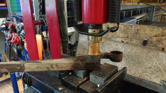

Drilling out the broken bolts for the ABS wire brackets and re threading take more time than pressing out the bushings. Replacing them with the front bushings I have replaced with caster correcting bushings.

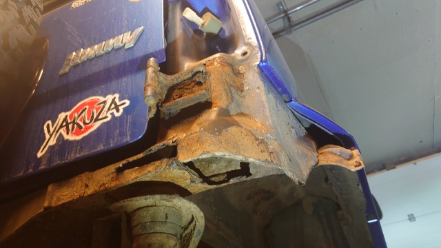

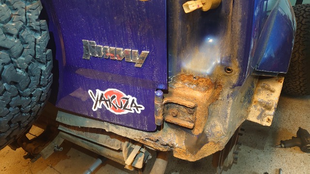

Last post was supposedly the most work on my list of improvements from the MOT garage.
Bushings on rear axle, leaky exhaust joint rear, license plate bulbs, yellow blinker faded to white and fog lights too low.
So i remove the rear bumper to get at the back exhaust.
And there was a bit of rust at the rear lower door hinge I started to scrape and peel and suddenly a hole at the bottom rear corner I can put my fist thru..

13 Jun 2023 15:42 #249516
Been out with man flu for days now, and eager to get started on the jimny.
One or two evenings should do it I guess.
Hoping to be back on my feet soon.
I was expecting this as I haven't been washing it so often, and have been postponing ripping all the plastic off it, to do the rust job.
