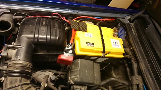

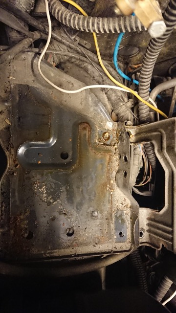

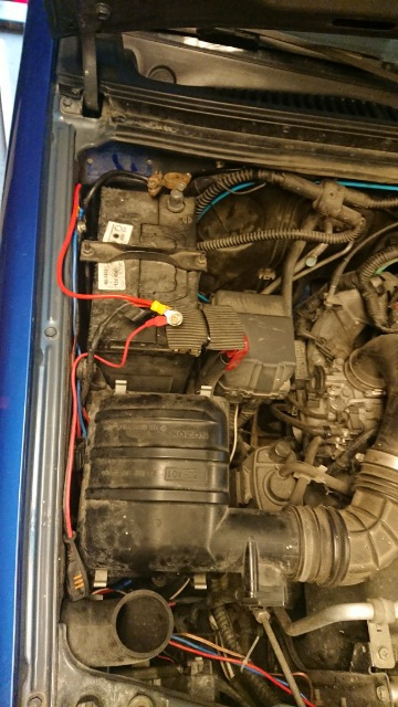

Old battery.
Ripped out and made room for a more common 18x20cm size.
Welded the bracket for the fuse box to the remaining tray after cutting the edges inwards away.
And got room for a 70Ah AGM battery.
Had to extend the positive wires, will change them completely when I get better parts for that.
