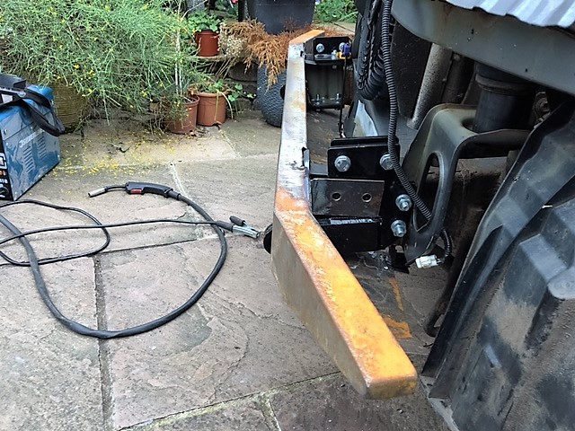

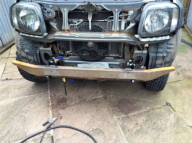

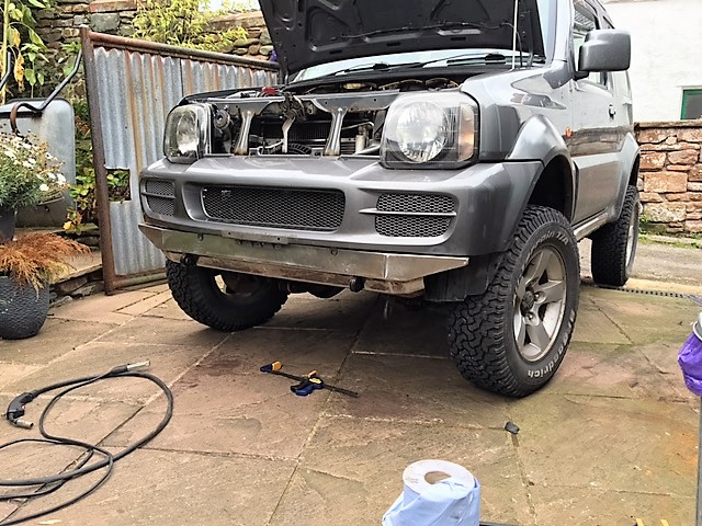

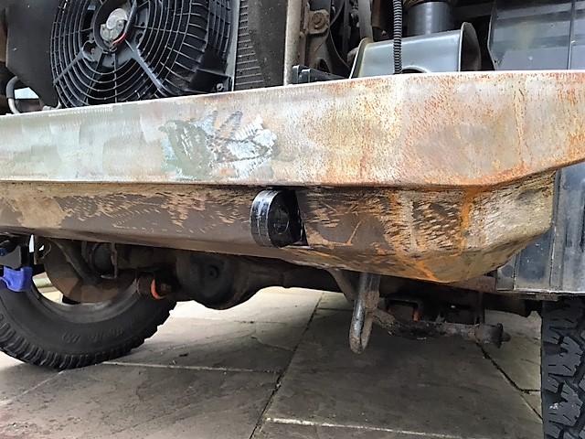

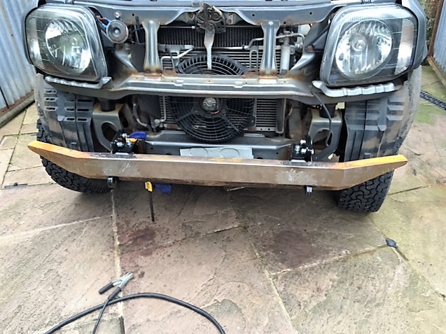

trial and error as you go. i kept fitting it, then adjusting to suit until i was happy with it. if you can weld then you can make this. its just a lump of box steel. cut it and fold/weld to get bends in the box. use a sheet folder for the plate. im messy at welding, but i can grind fairly well

Thanks all, dont really have the space for producing them but, if i make a Mk II then this Mk I above might be going spare
. it will only fit a newer jimny with a jimnybits 2" bodylift, jimybits front tow points and bumper cut accordingly. mine has a 2" trailmaster lift as well, but that wouldnt matter as its all chassis/bumper related. ive drilled/tapped the tow points to mount it and it has a cut out in the back which fits over the original lower bumper mounts snugly.
ive done all the front end with buzzweld since so its all nice and black under the bonnet
