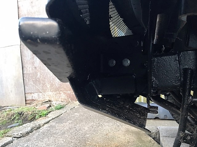

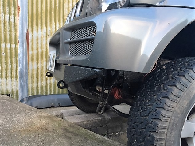

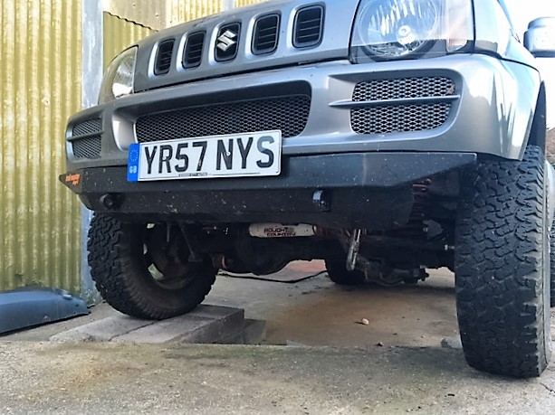

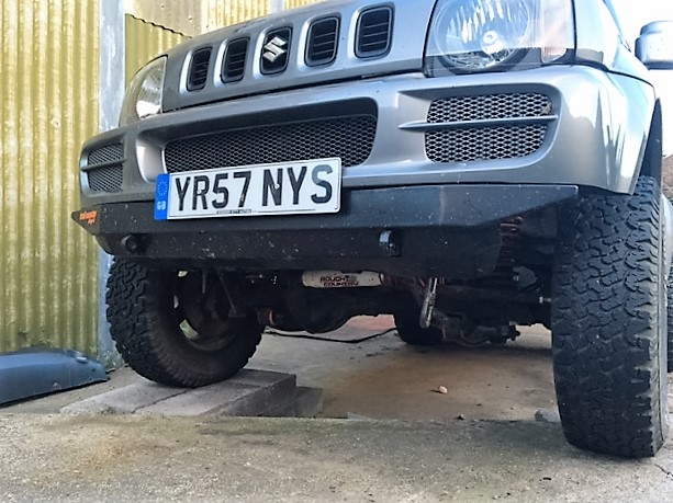

got the welder out and some box steel, steel plate, etc. made it, had it powder coated and bolted it onto the new HD towpoints. cost about £100 to make and powder coat.
mine has a 2" body lift also so i had to make it to fit the space and wrap around under the anti roll bar brackets to the original lower bumper mounts. the original bumper has screws behind the number plate so have used them onto the new bar for a solid mounting. its an odd shape so i couldn't buy one, other than custom made.
its the mark I tho, as i think it needs to go a bit further at either side around the cutoff bumper. and the folded bash plate thing is only 2mm plate so a bit thin for hardcore protection. i mainly made it to tidy up the look of it however so not a problem for me.
