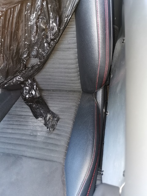

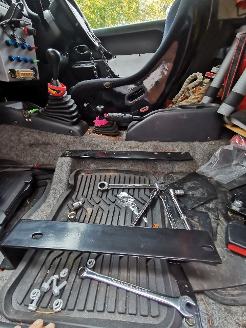

27 Oct 2023 14:49 #251806
Replied by jackonlyjack on topic My Jimny named R&B
You would need a seat subframe to bring mounting points flat
Not fitted yet if weather holds will be tomorrow
Not sure if gen4 seats are mounted with rail height differences like the gen3
My subframes where from landrover challenge
Only other supplier i could find was master forest

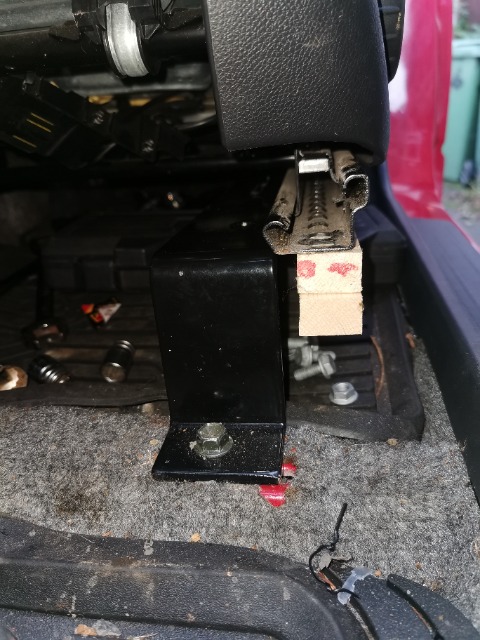

28 Oct 2023 14:12 #251840
by Roger Fairclough
Replied by Roger Fairclough on topic My Jimny named R&B
Yes, the Gen.4 seats are at a different level. J only J's picture has given me some ideas though. Cheers for that.
Roger
Roger

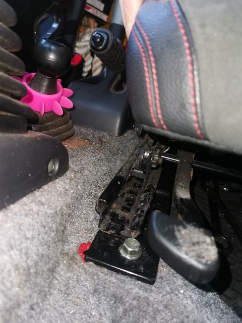

28 Oct 2023 14:17 #251842
Topic Author

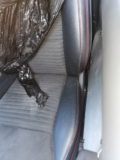

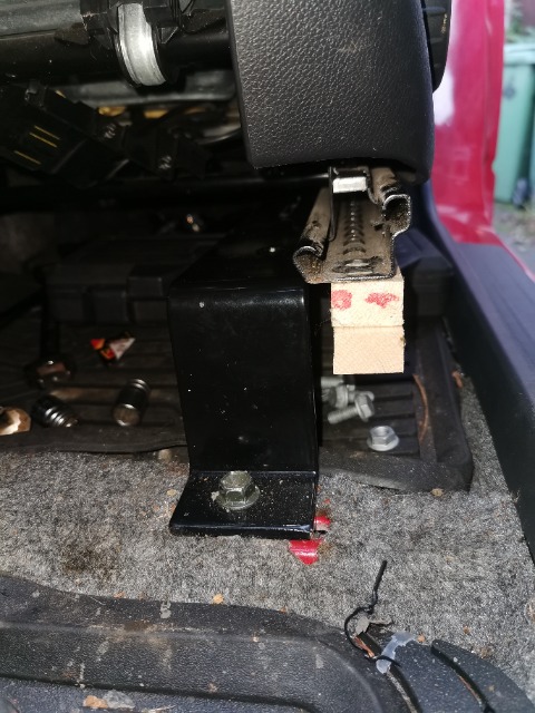

28 Oct 2023 15:47 #251844
Fitment on handbrake side is good
Need to drill a couple of holes
Outside rail needs a couple of 5mm thick tabs welding to match mounting holes
Need to get some flat bar so can't finish it
Can fit a couple of fag papers between the door card
