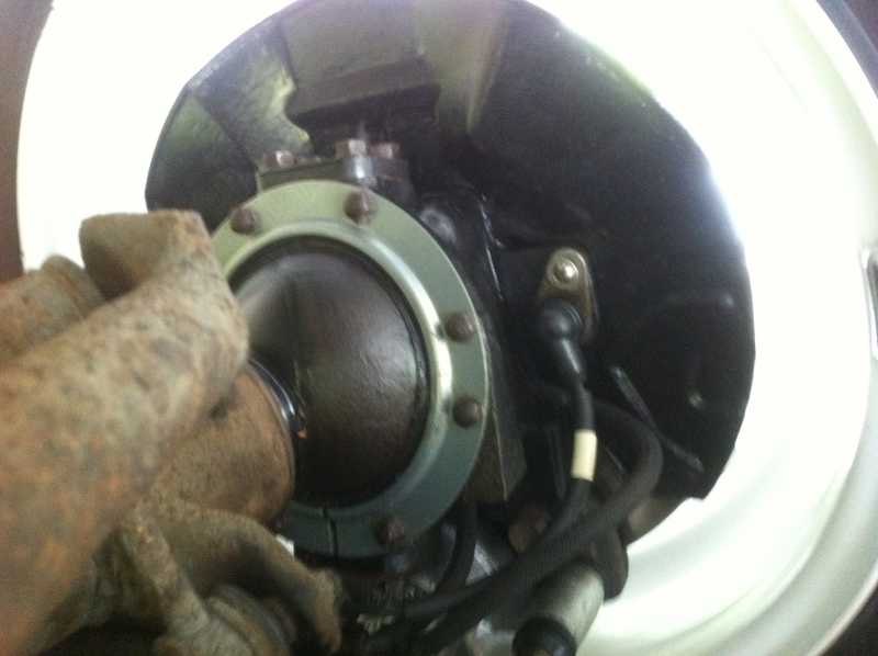

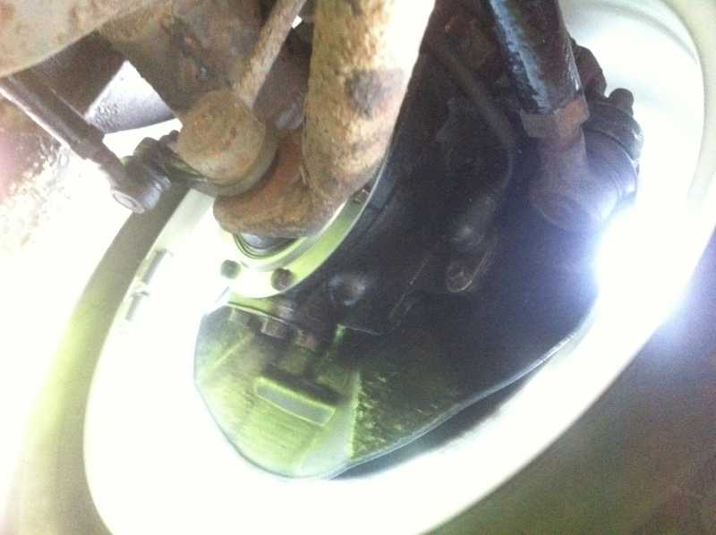

Kingpins, kingpin bearings, shaft oil seals, hub seals changed both sides and fitted new slider, bolts and boots to the nearside caliper. Treated the knuckles and tie bars to a coat of hammerite while they were off too. The steering wobble is much improved but still present a little bit in the same speed range but I'm going to get the front to wheels checked for balancing just to rule that out as they are big old heavy wheels and I can't be 100% certain 4x4 tyres balanced them correctly.
Next job is to get the diff filler plug off so I can change the diff oil, decided after a chisel and centre punch didn't work to order a specific 10mm wrench for the job so fingers crossed that does the trick.
