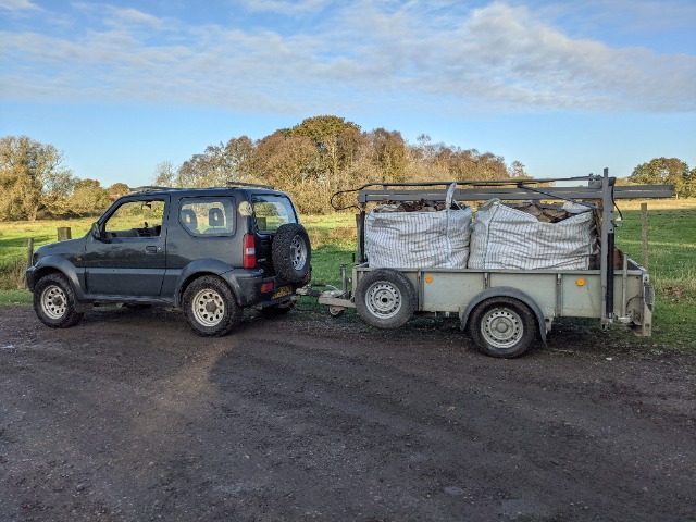

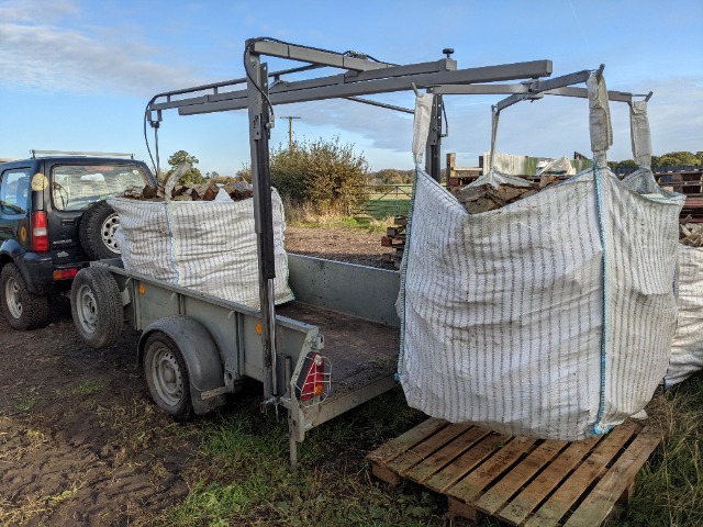

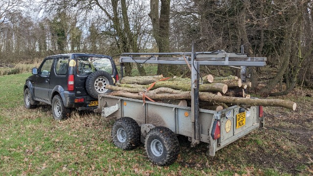

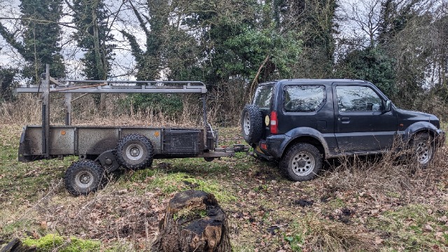

This is my current Jimny Forwarder setup for around the marshes. It's an area of very soft and bottomless peat bog, so not breaking through the top layer of turf is the name of the game!
I've made some low ground pressure rocking beam bogies that bolt to the hubs of my single axle trailer. With up to 800kg of wood in the trailer it travels as lightly as the Jimny. Jimny and trailer tyres are all at 10psi. Jimny in 4wd with Quaife LSD and welded front diff. Breaking traction is avoided at all costs!
I know it doesn't look like much of an off-road situation but, for context, we don't take our unloaded Defender on 32" tyres around here in the winter because it's too heavy and makes a mess!
