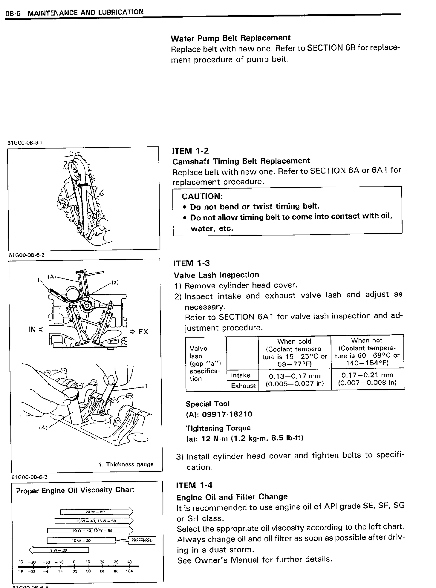

Can anyone steer me out of my tappets hell?
I replaced the head gasket on my 2003 Jimny. It's the deepest I've gone into car mechanics before beyond standard maintenance jobs, thanks to a lot of help from Google Gemini and this forum.
Everything went smoothly enough but now it sounds like a tractor.
After the rebuild, it started on first turn and ran beautifully - really smooth and quiet. After running for about 20-30 minutes, it suddenly went very tappety - noisy and uncomfortable.
So I've now adjusted the clearances three times:
- First time, a mate told me to set them all to 6 thou (I can't remember where he got that info from), but that made it worse.
- Second time, I left the intake valves at 6 thou and set the exhaust clearances to 10 thou. That made it very much worse. Very noisy with sluggish and lumpy revs.
- Third time, I set the intake to 5 thou and the exhaust to 9 thou. That made it slightly less worse than the second time, but still really bad.

Maybe we should start by identifying what engine you're dealing with - most folks would assume a 2003 Jimny with an M13a engine, but that is a shim over bucket arrangement, which does not lend itself to the sort of adjustments you're describing.

Ah yes, good call. It's the G13BB.
