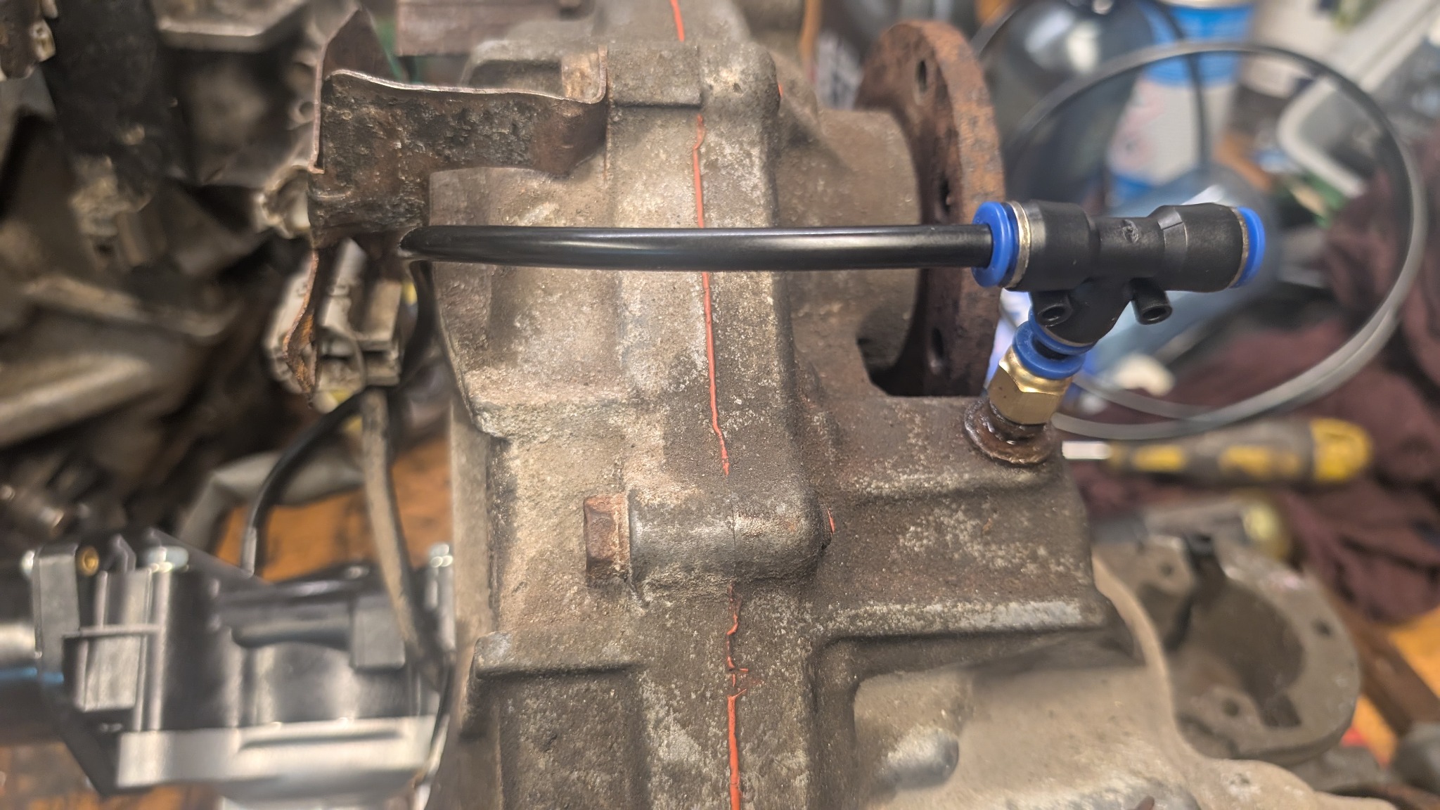

Ok to hook the actuator breather into the transfer case?

That should be fine, it's just air flowing through the breathers and not a whole lot of it.

Overthinking that there might be pressure differences transporting oil to or from the actuator.
Hooked it all into the air filter box too so there might be a bit suction. Havent checked if there is any oil up there.

The breather fitting would/should normally be well above the oil level, so chances of oil entering the lines during normal operation are quite remote.
