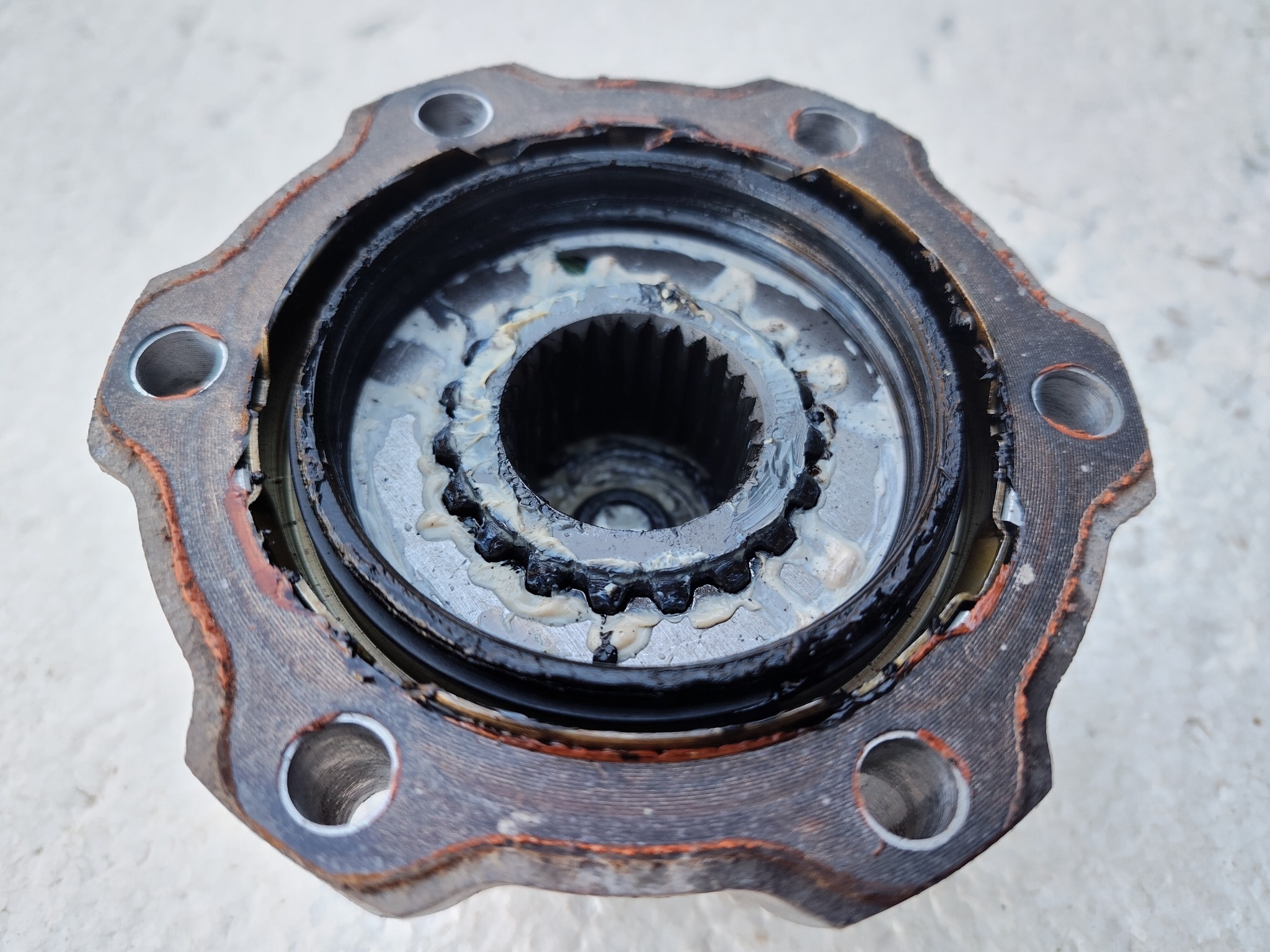

I removed both vacuum hubs with 2WD on.
The left hub's sleeve was up (picture attached). The right hub's sleeve was on the bottom with magnet.
Also the left hub's magnet works when you push the sleeve by hand.
Both vacuum hubs seems clean and ok.
When I put hubs back the right hub works fine, but the left hub's problem remains.
For me it seems that the problem has to be in left vacuum hub, because I have changed the vacuum hoses and the right vacuum hub works fine. So I assume that the problem must exist after T-joint in the left line. But I don't understand what could be broken because everything seems ok and the system seems quite simple.

The left hub was engaged, the right one free, I thought the noisy one would be the free one, (if you use your fingers you can rotate the inner splined part if the hub is free/disengaged.)
As Lambert says with the black outer hub off blow through the two short ports to make sure that they are clear. Changing the wheel bearing can block the ports with grease, one air passage is through the bearing.
If the bearing is failing there will be a vacuum leak and the hubs won't disengage (I'm fairly sure the disengage path is through the bearing and the engage is along side the CV joint) , the seal in the bearing (and the one round the CV joint) must be sound.
The pipes could be crossed over and the hub working backwards, or there could be a leak or blockage in the pipe that disengages it.
The following user(s) said Thank You: finjim
