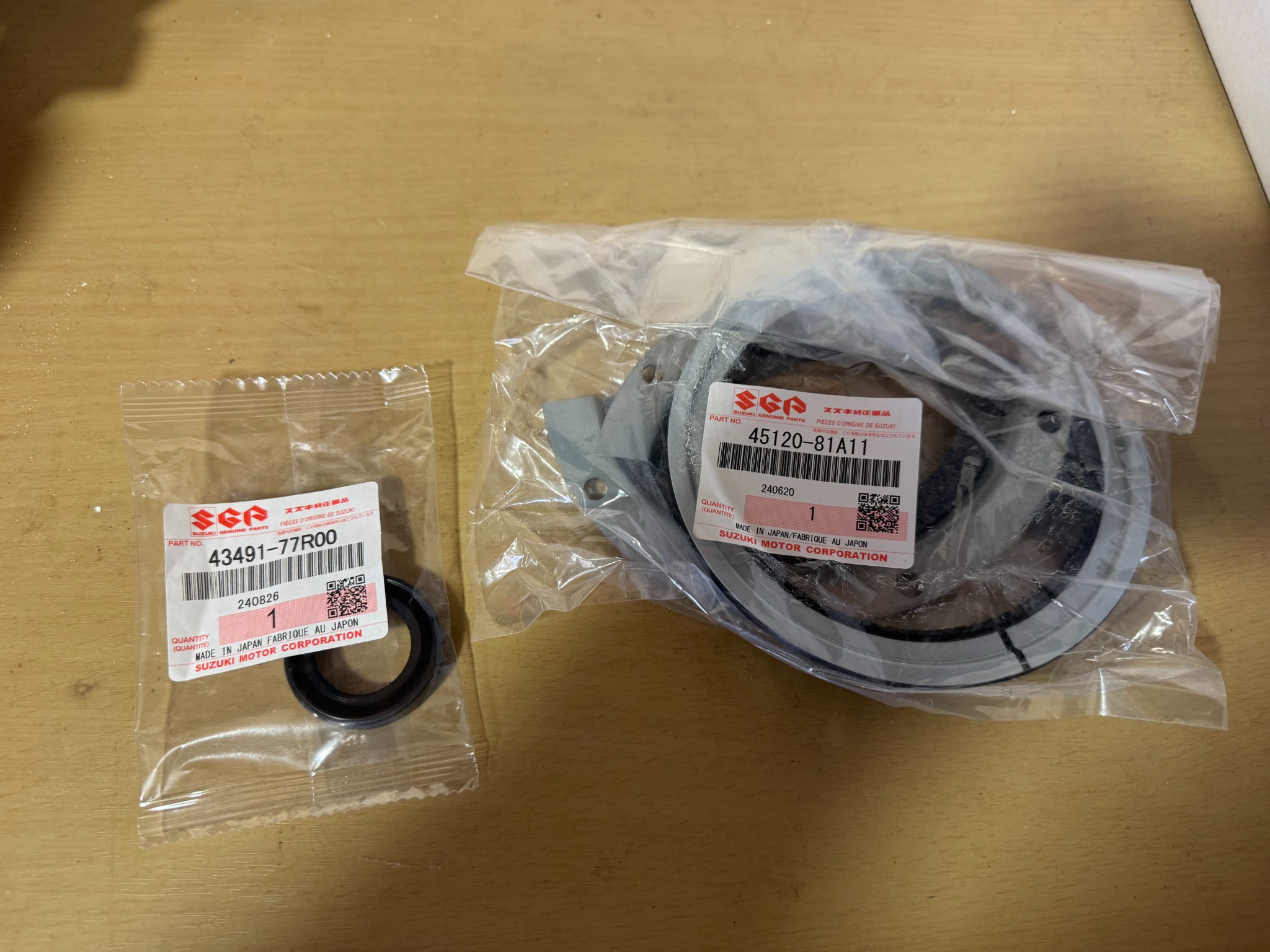

The inner seal to the diff was the culprit. The axle is fine, looks suspiciously like new. We suspect the previous owner replaced it after the accident. I can't understand why they didn't replace the €4 seal too... We also changed the outer knuckle seals, overall €25 for parts. Hopefully we won't be leaking anymore

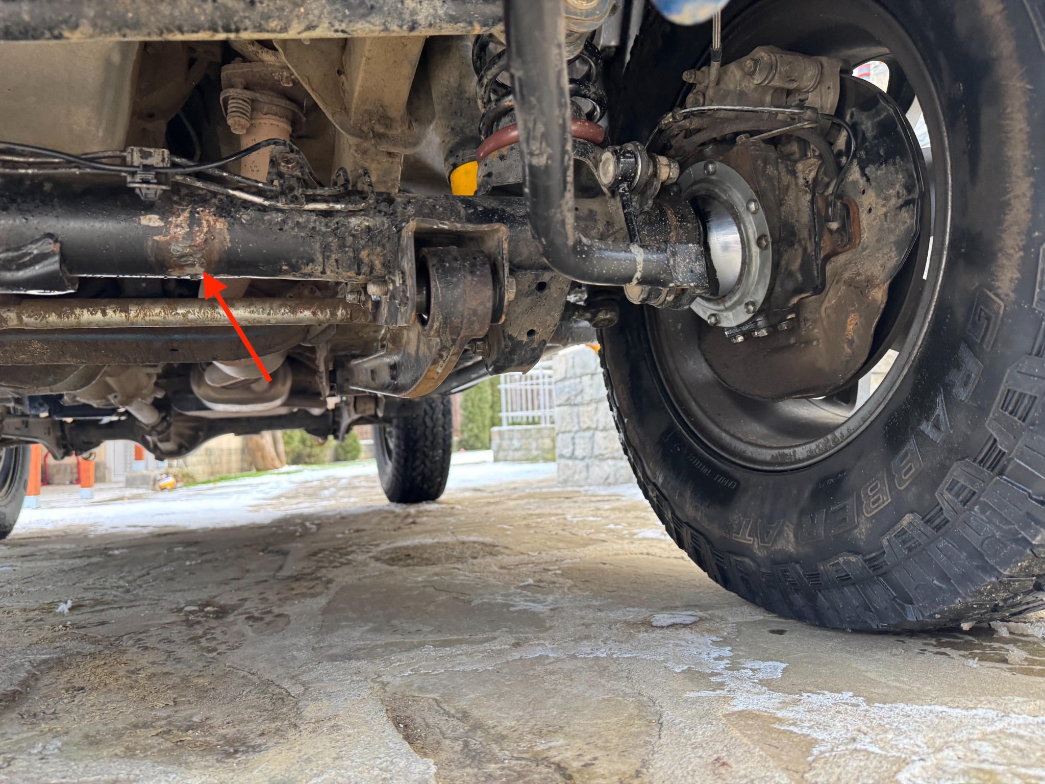

To elaborate, this is why I think the axle was replaced. It looks like the tunnel was severely bent, then repaired, probably by cutting and welding... I doubt the axle survived that. The kingpins are fine, we've checked them and they provide the necessary resistance to avoid death wobble and indeed, the car runs straight under acceleration and braking without pulling or wobbling with speeds up to 140km/h.
