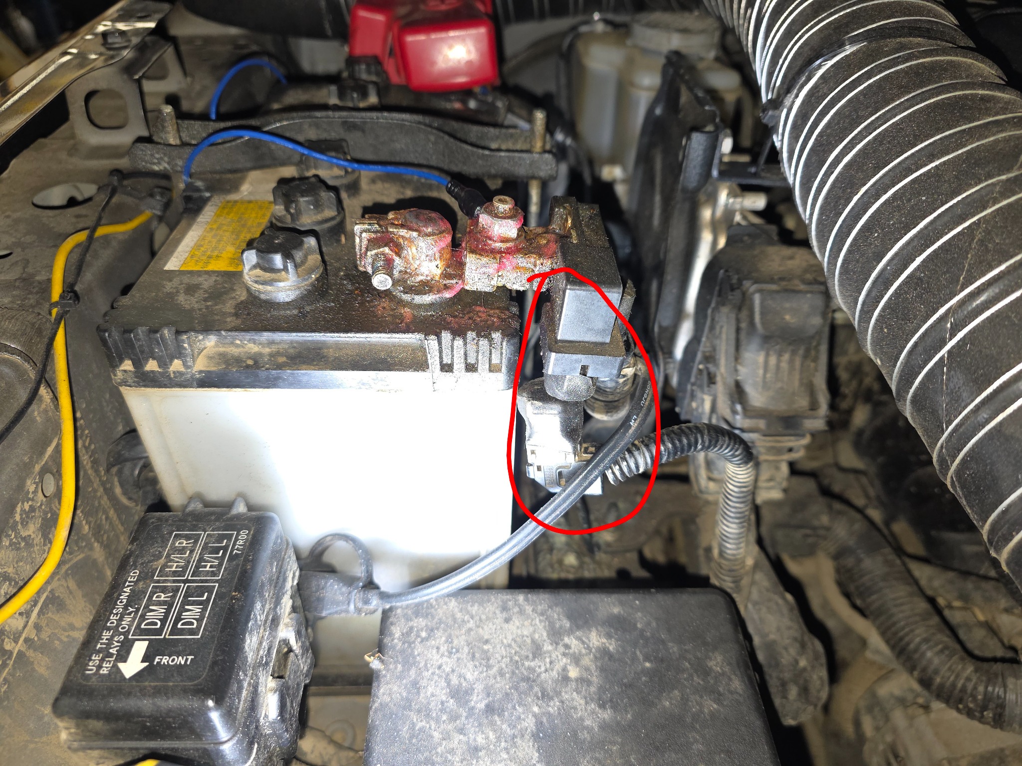

Electronics is not my forte, so I am going to need a step by step guide to just what I have to do to remove/disable whatever it is to overcome the need to charge my battery every 4 weeks or so.
Many thanks Soeley and pics would be gratefully received.
Roger

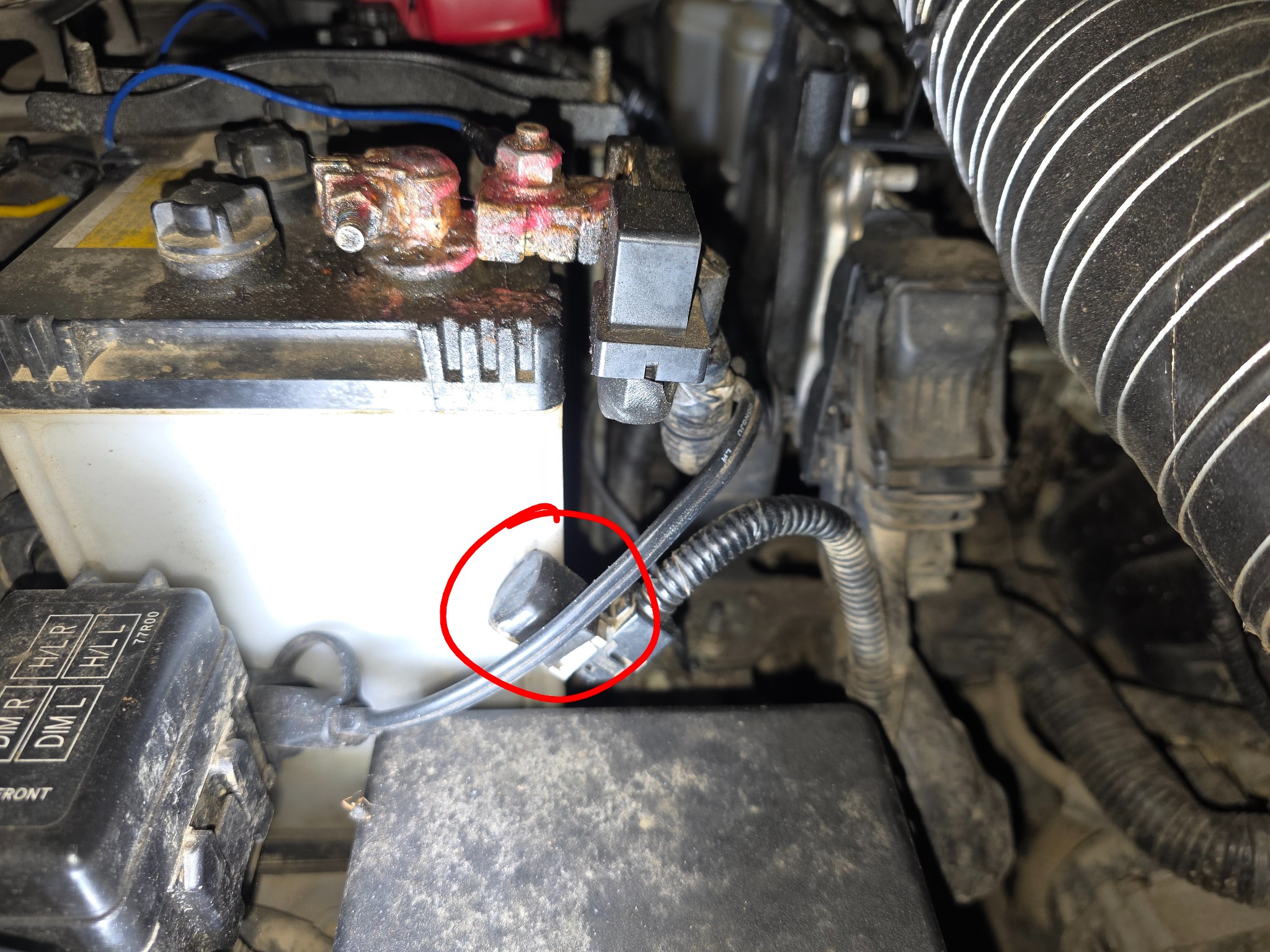

You can call me Mr Hamfisted & Stupid if you like, but how do you part the connector without breaking it (or ripping the sensor apart)?
There is what looks like a catch to press on the front, but I'm not strong enough to press it in with fingers and release anything. If I try harder with a tool it will likely shatter in the cold.
When the rain stops (tomorrow) I was going to get a pick and see if gently prying out what seems to be the other end of that tab will work.
The real question is do I just press the tab in harder and pull like fury, or press and slide something to release it and it drops off?
(I usually break 50% of any connectors or plastic clips, I can never get them to release )

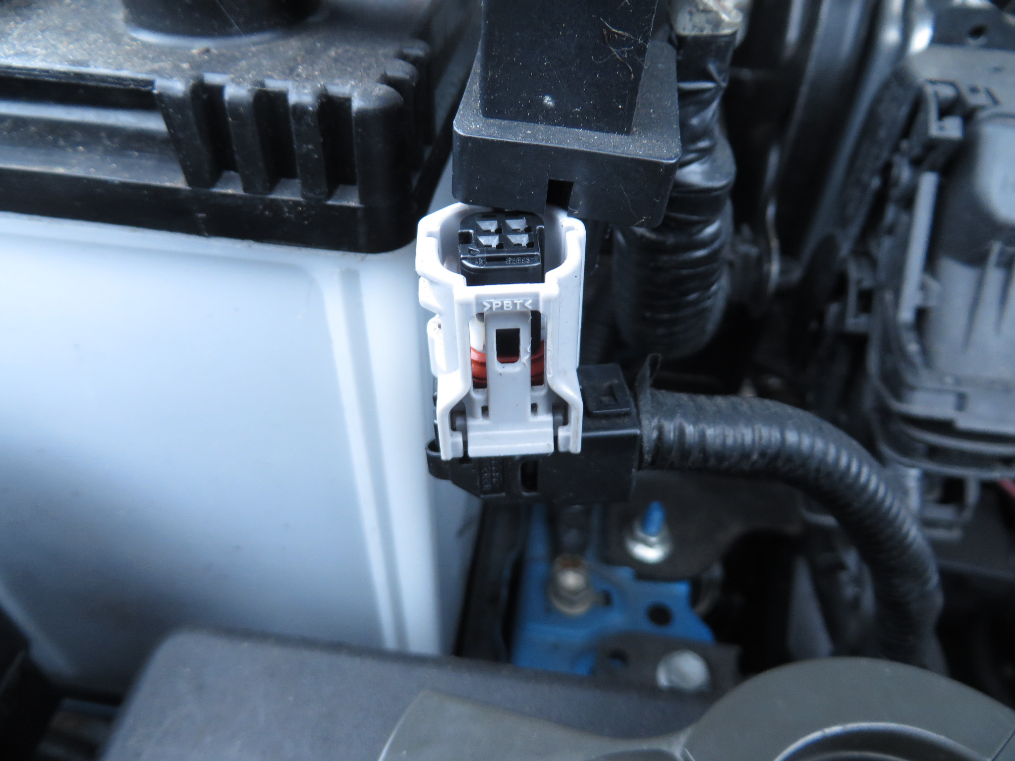

Replying to my own question...
The rain stopped for a few minutes, so out I went.
As I first thought, you have to prise the tang outwards off the peg on the sensor, then the plug easily pulls off- see all the shaved plastic where I levered it.
There is no way you would ever move the tang far enough by pressing the tab at the other end.... (Maybe you squeeze the two flat sides inwards towards each other with sufficient force that the whole jobbins distorts and it moves the tang outwards by itself, I never thought to try that)
Result!

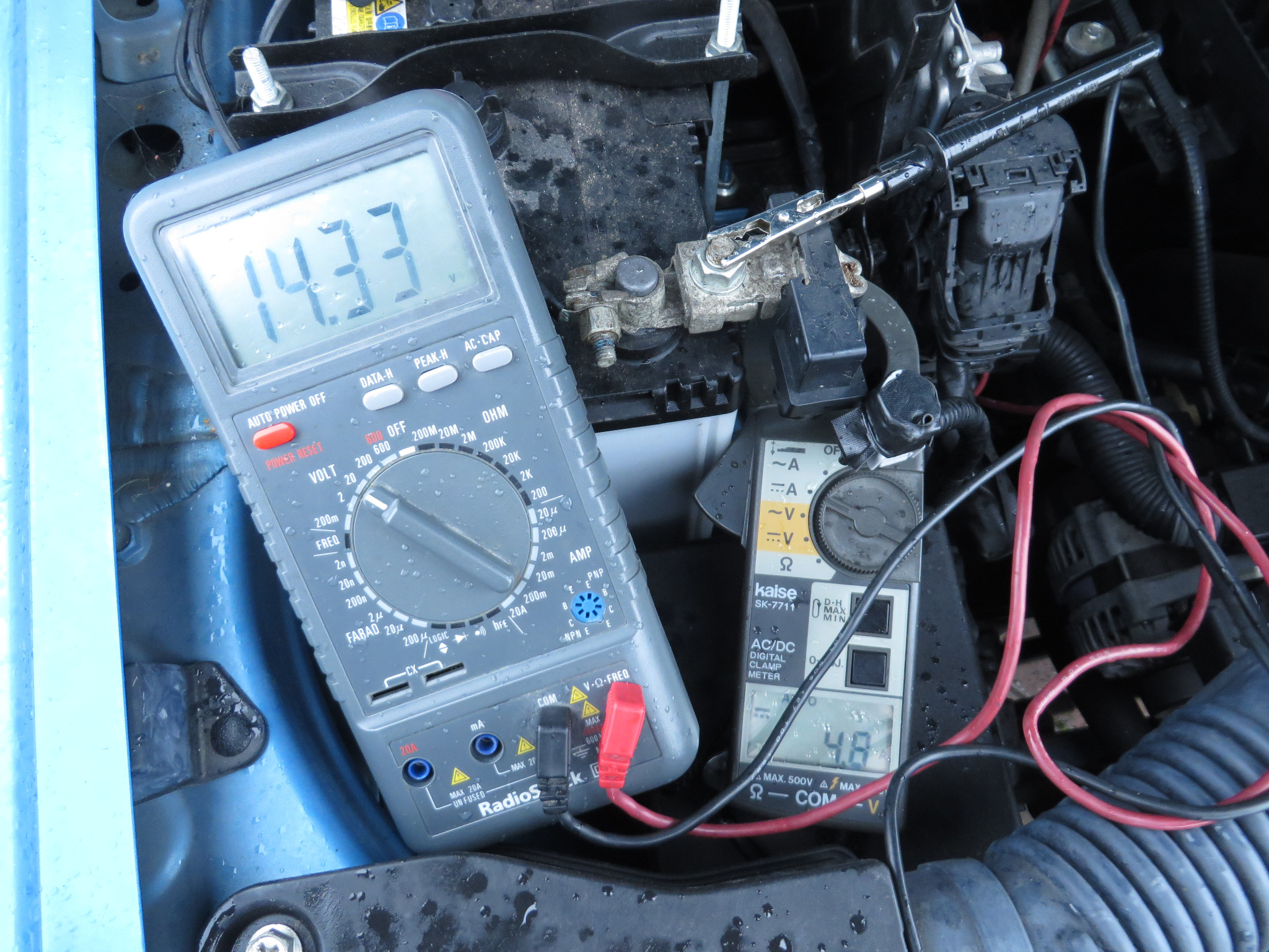

A nice 14.3V across the battery, and it is charging at 5A, which is about right as I had it on the Optimate yesterday, I should have tried it before I charged the battery all day!
(yes it started raining again...)
Result!
No warnings popped up- well the low tyre pressure one was displaying, but nothing overrode it.

To be honest, I can't remember without going and unwrapping it? Sometimes on the smaller connectors though, I do use a small screwdriver to push the tab in, as the small ones don't really give enough room to get your nail in far enough.
