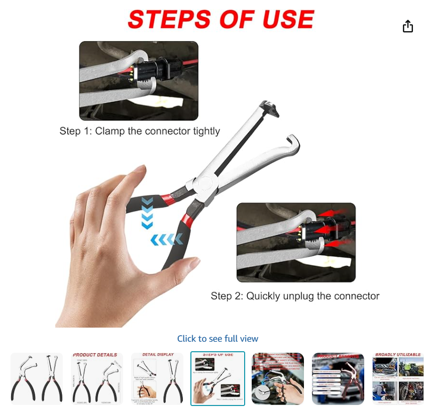

There must be secret techniques for undoing these connectors, like I said I'm forever breaking them, or at least the securing mechanism, because I can never get them to unlatch, and pretty much every one is different.
I wonder if you are supposed to use a tool similar to pliers that squeezes the flat sides together and the distortion of the plastic bows the tang outwards to release it, then you flick the tool down to part the connector.

Thanks,To be honest, I can't remember without going and unwrapping it? Sometimes on the smaller connectors though, I do use a small screwdriver to push the tab in, as the small ones don't really give enough room to get your nail in far enough.
I did it with a little screwdriver (A pick would have been better, but they are in the garage)

Replied by Soeley on topic GEN 4 Disconnecting the Battery Sensor
You can get these, I might invest in a pair as my fingers aren't as nimble as they used to be.
Amazon Link
Amazon Link

by facade
Replied by facade on topic GEN 4 Disconnecting the Battery Sensor
Ah!
I have a vague recollection of buying something like that from eBay the last time I broke some connectors!
I will have to look in the garage, and in the drawer in the shed where I keep The Really Useful Tools That I Bought On A Whim. (Like that gadget with the ACME thread for cleaning out the guttering- it screws onto the drain rods that I don't actually have..)

16 Dec 2025 12:31 #263088
by Roger Fairclough
Replied by Roger Fairclough on topic GEN 4 Disconnecting the Battery Sensor
The locking clip is the white upside down "T". Push hard on the new bottom and pull it downwards. It may help to warm the clip with a hair dryer.
