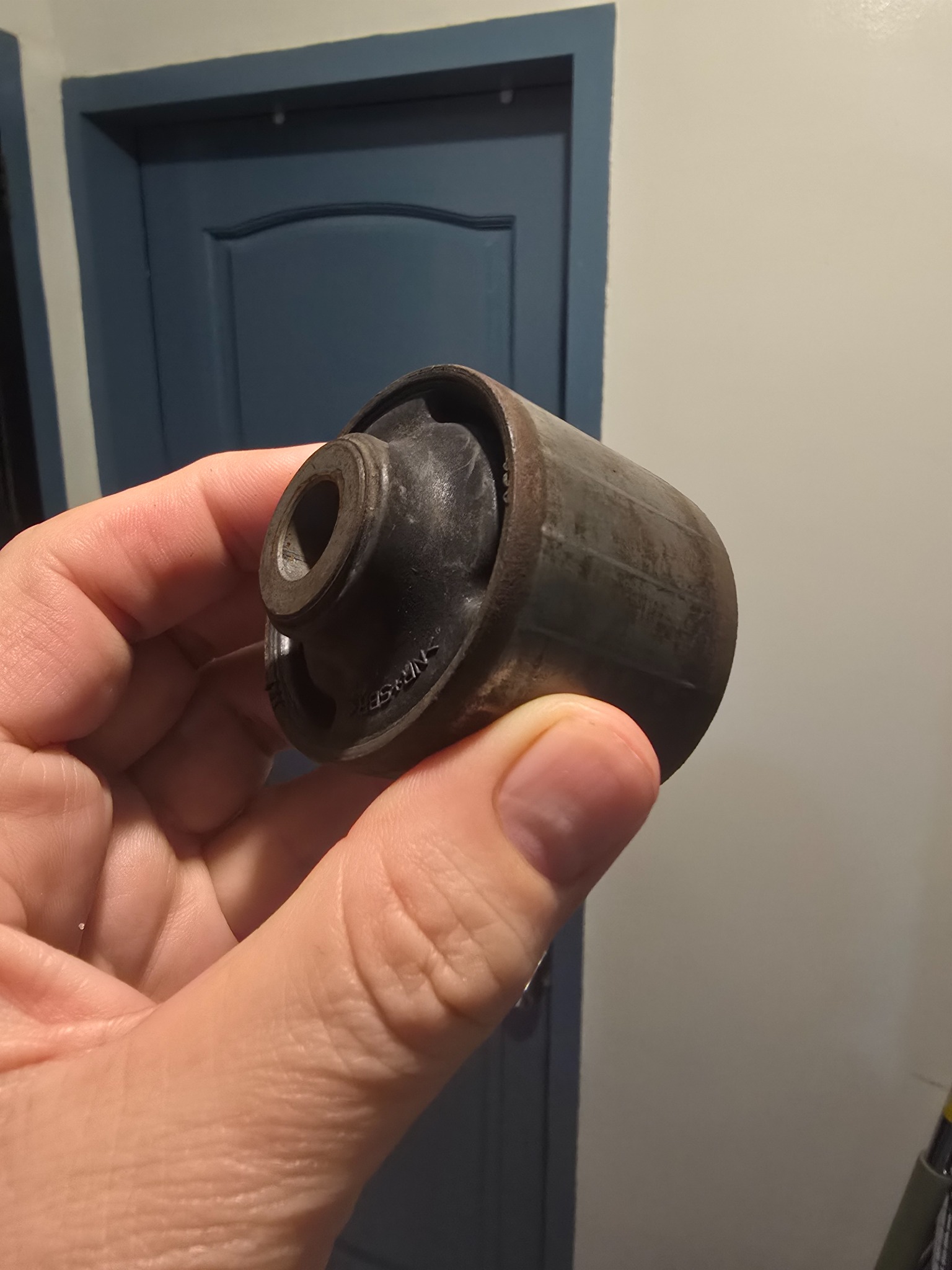

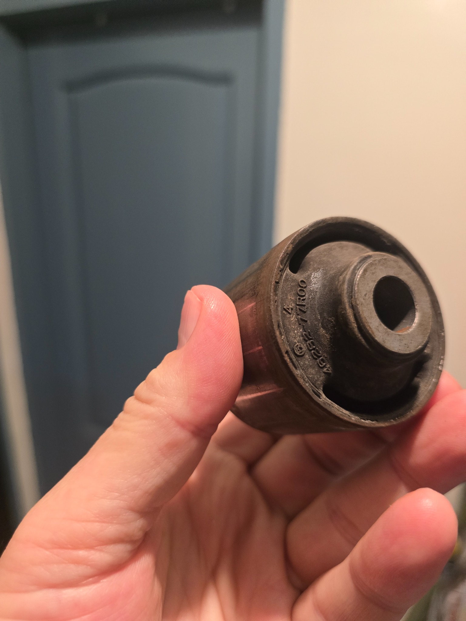

21 Nov 2025 16:07 #262872
by moab762
They are intact. This is one of the originals.

Replied by moab762 on topic Bushing install?
