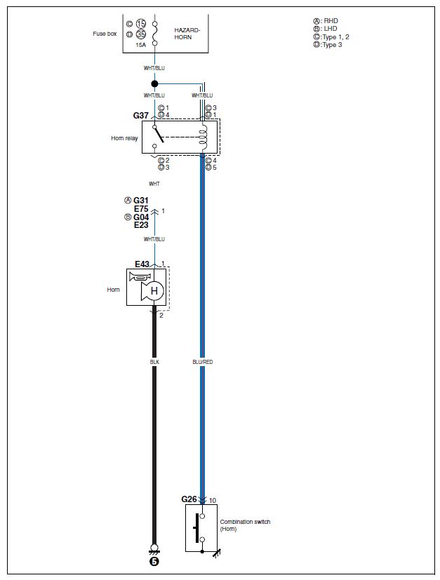

Hi , after a few problems now sorted, I am having trouble with the horn working, the two connector to the horn show a blk wire ground good, and a wht/blue Nothing.the horn buttons show a 12 volt feed in ,tested horn direct and it works, any ideas. Also tested fuses.

Here's the horn circuit - I'm not certain how the horn wiring is done on a Jimny, if it's air bag equipped there should be a clock spring, if there's no airbag then it may or may not be grounded via the steering column.
Leave the meter connected to the horn button feed and then push the button(s), the voltage should drop to zero, if it doesn't you've more than likely found the cause - there's no ground - finding how/where it should be grounded might be challenging, especially after a body off restoration.
Let's be optimistic - when you push the button, the voltage does drop, that would suggest a defective horn relay.

Thanks I'll look tomorrow, I'm not sure where the relay may be found, this is a 2000 jimny
31 Jul 2025 17:32 #261412
by fordem
Replied by fordem on topic Horn problem
Should be up under the driver's side dash.

I grounded the horn button wheel cover metal to chassis and made sure it had an earth,pressed button but voltage stayed the same, I can't see both horn buttons failing.

I just tested the horn buttons with the battery disconnected, for continuity from input to ground ,when button depressed no continuity reading,?
