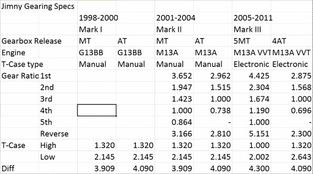

When I broke my diff it was the same price in the junkyard for the diff as for the complete axle.
Your diff have the 3.9 4,09 ratio and it is the same ratio on all auto from 99 to 2018 as far as I can see. Axles from all the years will all fit your car as long as it is from an auto.
Edit: I got it wrong, see below:
Still a lot of cars with 4.09 diff ratio to pick from.
www.bigjimny.com/mediawiki/index.php/Tra...ssion_gearing_ratios

Your diff have the
