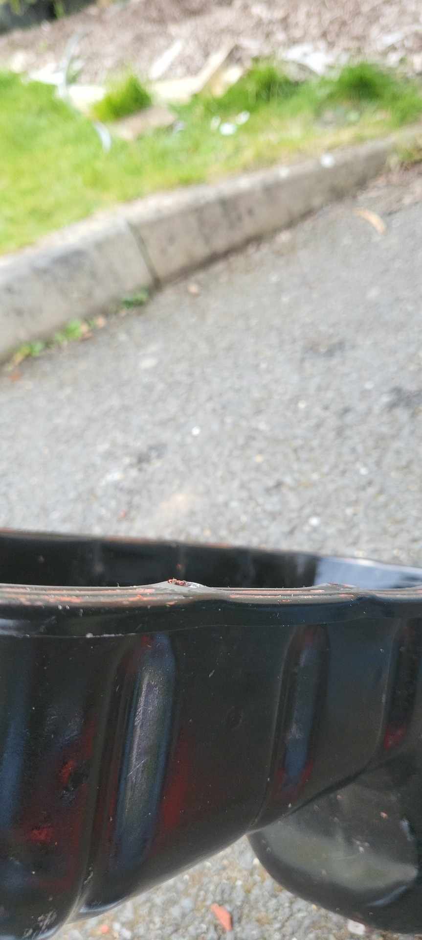

21 Mar 2025 21:21 #259871 by Island_Jimny
Update
So it looks like the aftermarket gasket was at fault. Covered in oil on removal. Also despite tightning the bolts to only 10nm the soft gasket allowed the pan to deform around the holes.
Anyway new one on now with black gasket gunk. Left it to set overnight and test tomorrow.
Also found 2 more stripped bolt threads in the process so I'm hoping everything will hold till its next oil change.
Thanks for all the advice so far
