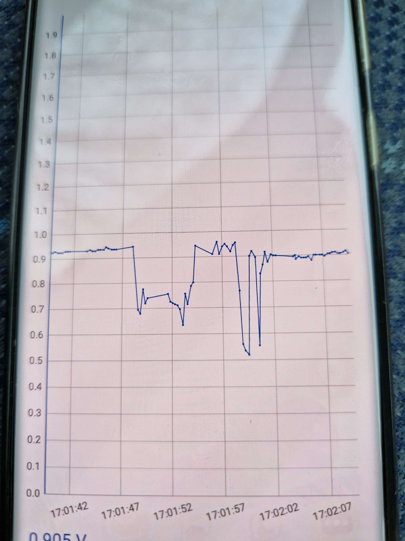

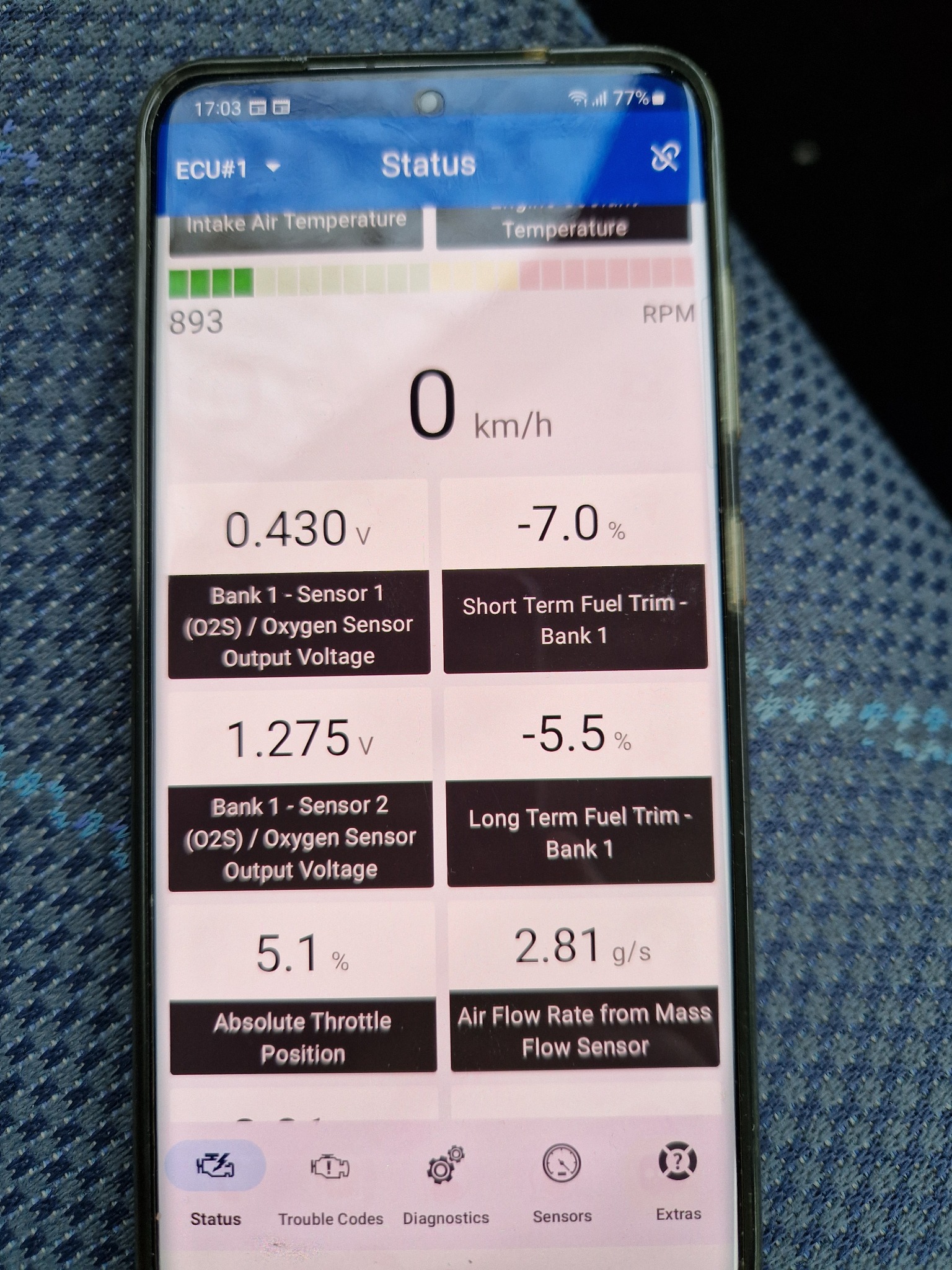

Checking the OBD both temp sesnors are accurate. Attached is a couple of pics: 1) engine idling showing fueling. 2) 02 sensor output showing touching the throttle.
My thinking is the ECU is overfuelling when touching the throttle due to the TPS reading 5% when throttle is closed. Anoy other ideas?

Thanks for the replies, good to know the TPS is OK. I've done some back to back testing with and without TPS.
With TPS (stalls when blipping throttle)
TPS: 5.9% at idle
Long term fuel trim at idle -2.3%
02 Sensor: 0.92v
When "blipping" the throttle the fuel trim momentarily goes to -5.5% and the O2 sensor to 0.4v
Without TPS (No issues when blipping throttle)
TPS: 100% reading according to OBD
Long term fuel trim at idle -8.6%
02 Sensor: 0.9v
When blipping the throttle the fuel trim momentarily goes to -2% and the 02 sensor is pretty stable but drops to 0.8v
So it seems with the TPS the long term fuel trim goes the opposite way (from -2.3% to -5.5%) making the engine go lean and stall. (the TPS % opening does increase when touching the throttle)
Without the TPS the fuel trim goes from -8.6% to -2% and the )2 sensor voltage only drops to 0.8V.
Any idea's why this is happening?
