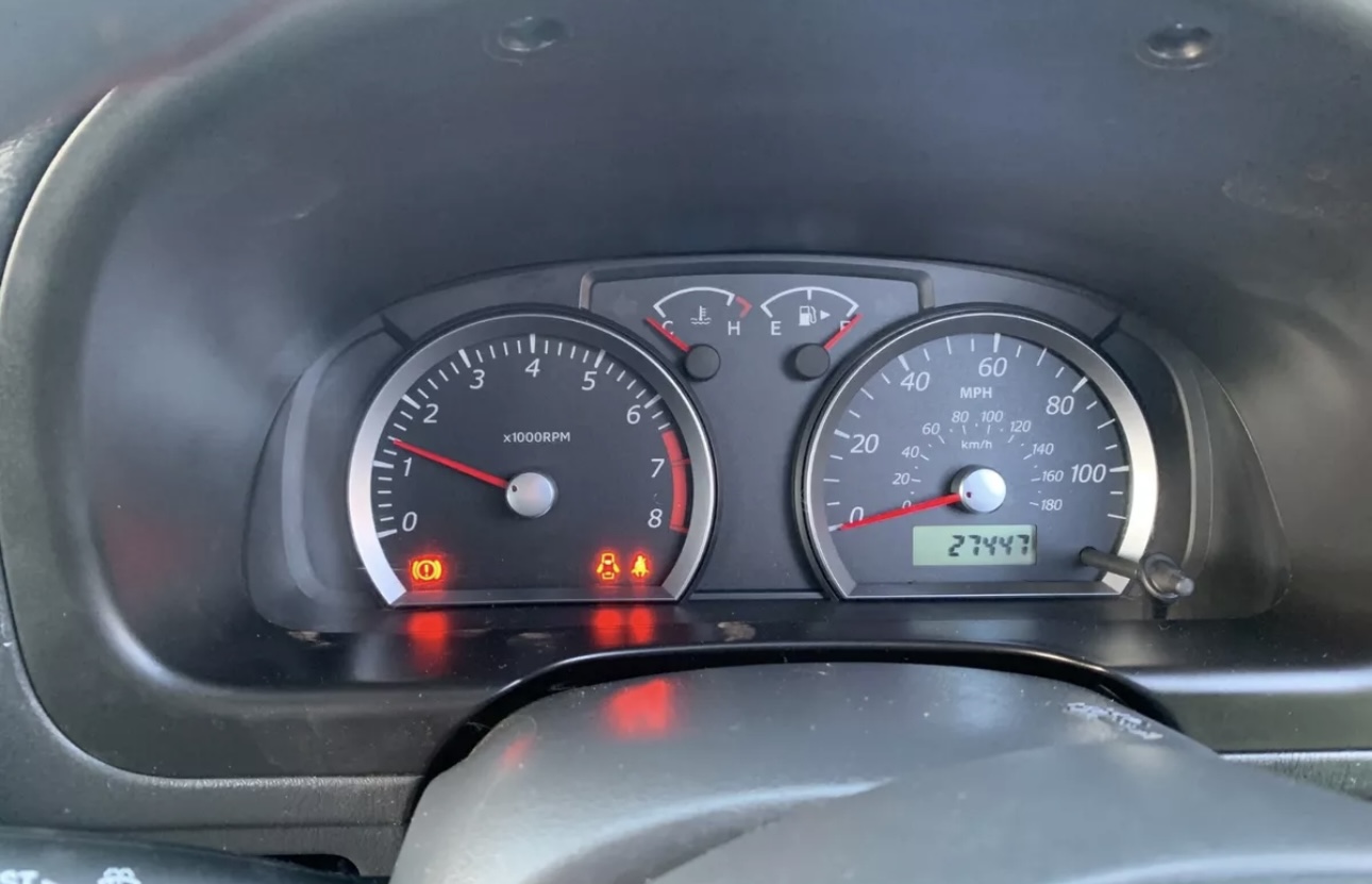

Intermittent display loss
18 Feb 2025 20:49 #259521
by Lenlec
Intermittent display loss was created by Lenlec
19 Feb 2025 08:00 #259522
Replied by yakuza on topic Intermittent display loss
The milage is stored in the dash cluster and not in the ECU so it is more or less a stand alone unit. I would check the ground points in and around the dash, check for good battery voltage, check plugs and fuses.
Any aftermarket stereo or other jobs done in the dash are most often the cause for problems here.
Also would check the main fuses next to the battery if they look OK. However it is not a typical Suzuki problem but other cars often have trouble with damp and bad contacts in the main fusebox.
