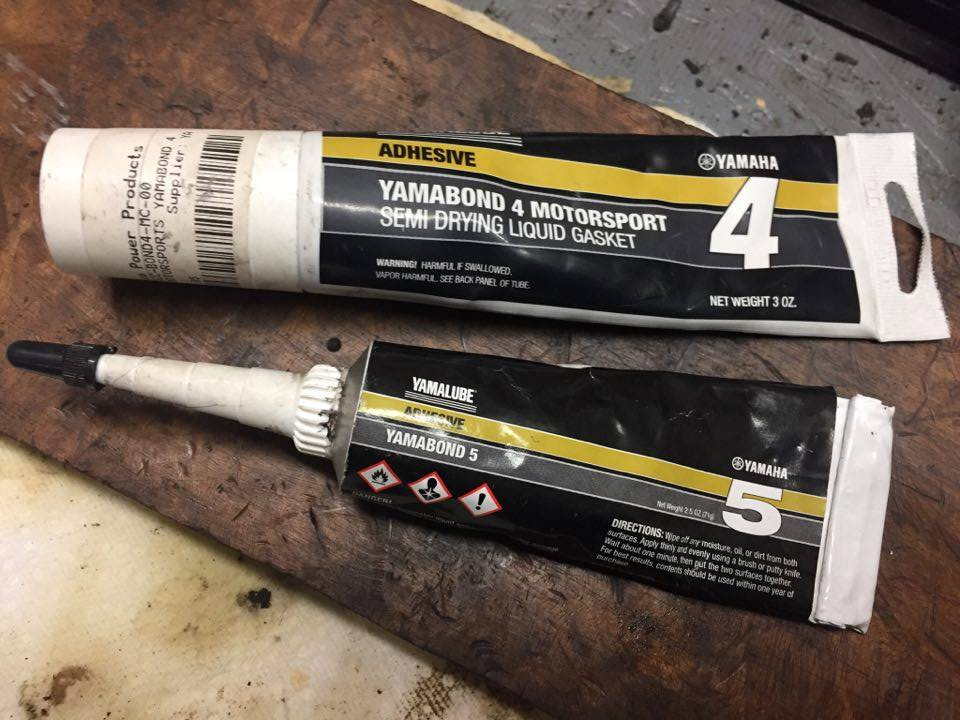

08 Jan 2025 16:49 #259021
by Filipao
Replied by Filipao on topic Sump pan - suitable RTV
