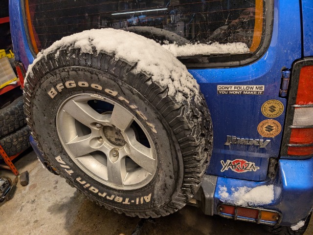

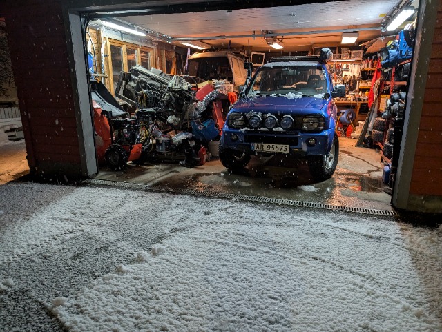

Come to think of it I allready got a BFG AT and even in snow.
Still happy I do not have AT 's Today though just barely missed the side of a Honda that jumped into the road Today. She got all my headlights and the horn while my studs tried to get a grip..
Getting 20cm Today
Getting 20cm Today
