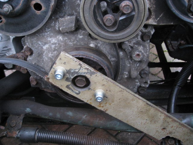

150Nm. You might need to make a locking tool that picks up on the two threaded holes in the centre and clamps against the face of the pulley.

Thank you so much for the quick reply and the information.
I modified a large spanner to remove it. Hoping I can reuse the modified spanner to tighten again

150Nm, it says there. So more than a wheel nut. I am assuming this is for dry threads, with a new bolt.
Double and triple check the Woodruff key is properly located before tightening.
