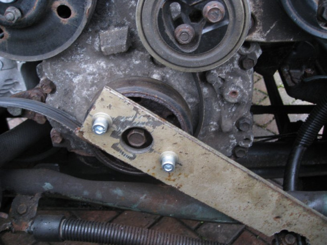

With an auto they will need to make a locking bar to tighten it up again.
I made one from a piece of old desk I had knocking around, I can't remember the hole centres, around 75mm I think (but they can measure off the new one, the bolts are standard metric threads, probably M8), my bar needed notching so it goes round the PAS bracket.

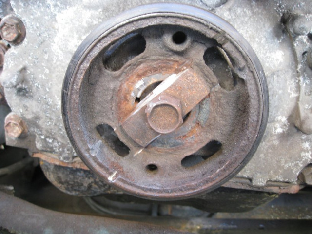

Nothing on Earth would undo the bolt on mine, it was rusted solid, so after a couple of evenings of futility with rattle guns and scaffold poles, I simply sliced the flange off in pieces with a grinder (the crank nose is about 3mm short of the pulley) and undid it with my fingers!
