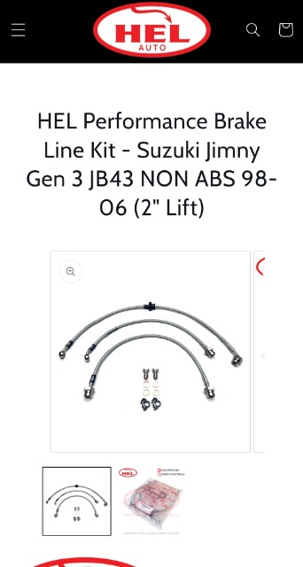

I was going to purchase the Hel set from Jimnybits but decided to research it to make sure I wasn't missing anything. I found what looks to be the same Hel kit on the Hel website but it specifies it's for a NON-ABS Jimny and I couldn't find a set the specifies it's for ABS... Believe it or not, my '98 Jim has ABS, so I'm not sure where to go from here.

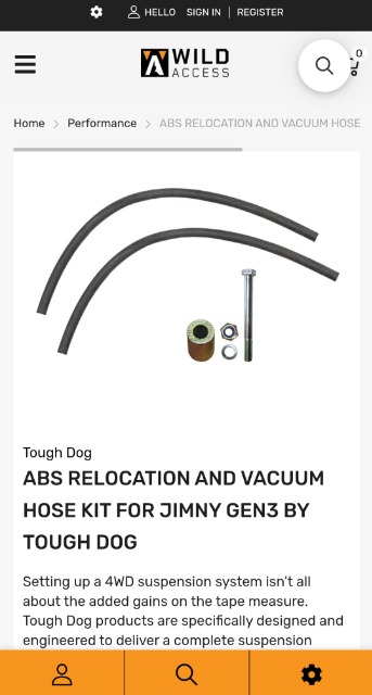

What have other people done with regards to extending brake hoses and dealing with ABS? Was there something you had to do other than buy an extended brake hose kit? I've seen an ABS relocation kit for sale in SA (I'm in NZ) but I've never heard of anyone doing that on any of the Jimny forums/discussions I've seen. Am I overthinking this all?

I think my extended hoses came with my lift kit. I have ABS too and I cannot quite see why ABS or not makes a difference for the front brake hoses. The brake calipers are the same.

Relocating the ABS is for the gen4 with very much lift I guess, haven't heard of it being an issue on the gen3. I would not fiddle with the ABS pump, it is very expensive.

Okey! I wonder why Hel specified for non-ABS, it's really throwin' me off! Jimnybits also suggested the Hel kit to me... maybe it'll be alright then? I was hoping to order them in so that lift and hoses can go in at the same time but didn't want to waste my money on a purchase that wouldn't work.
