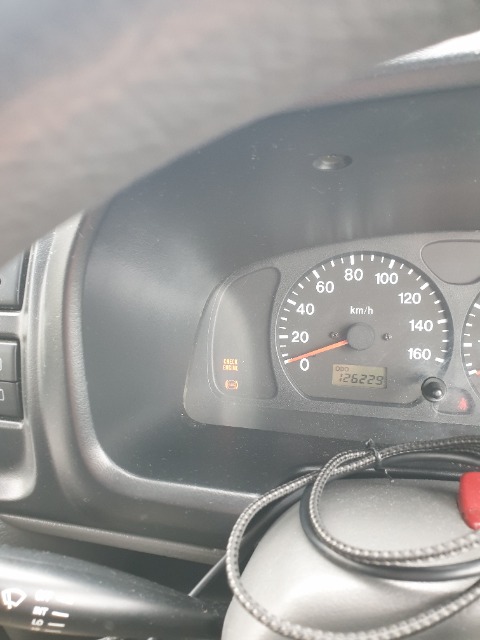

I was going to purchase the Hel set from Jimnybits but decided to research it to make sure I wasn't missing anything. I found what looks to be the same Hel kit on the Hel website but it specifies it's for a NON-ABS Jimny and I couldn't find a set the specifies it's for ABS... Believe it or not, my '98 Jim has ABS, so I'm not sure where to go from here.

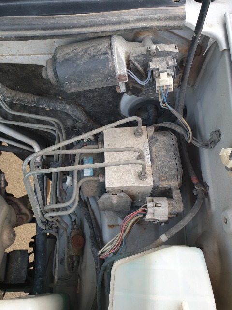

Relocating the ABS is for the gen4 with very much lift I guess, haven't heard of it being an issue on the gen3. I would not fiddle with the ABS pump, it is very expensive.
