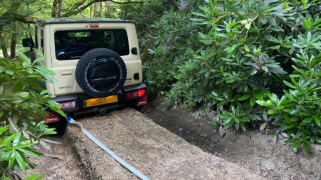

This does depend what you do off road. Regular lanes will probably be fine. But I was going round some RTV trials sites. The relatively poor break over angle catches you out on technical terrain. The transfer skid will loose an inch or so of clearance. But the guard I have fits pretty snug. It does create a smooth underside less likely to get hung up on.
The diff guards will split opinion more. I’ve never run diff guards on any Land Rover I’ve owned and off roaded. Although my brother did reverse into a rock laning the other year in his 90 and put a dent in the diff case.
With any diff guard you will loose clearance and run the risk of being beached more easily. The small wheels of the Jimny you are already at risk of this. However I’d also say that as the diffs are lower they are also more vulnerable and more likely to clonk a rock or boulder on a green lane. I have diff guards fitted to mine. I have been beached too. But I don’t think not having the guards would have saved me.
