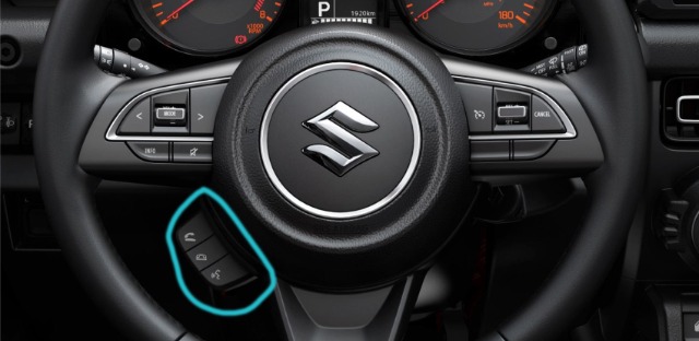

Here in Latin America GL Version which is the only one we get here. Does not bring them. But Ive managed to add them but the ones I have instead of the voice command icon have a bluetooth icon I would like to get the part no. Of that one the one with the voice command icon

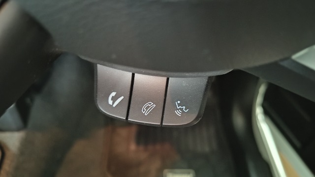

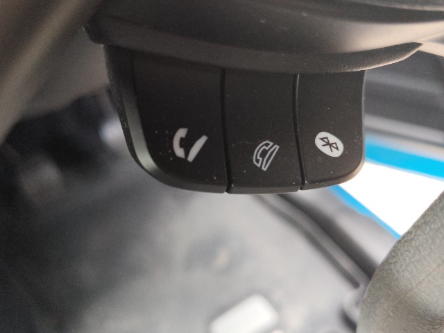

Replied by mlines on topic Steering Wheel Media Controls Part no.
The controls are only sold here (UK) as a complete steering wheel.
We have two variants, here are pictures of both parked out on my driveway
The "Voice" version is fitted to the SZ4 and LCV versions of the Jimny 48110-78R60-HLF
The "Bluetooth" version is fitted to the SZ5 version of the Jimny 48110-78RK1-HLF

Oddly my SZ5 has the 'voice' version rather than the Bluetooth one. Wonder if it's an early/later car thing?
2 years 3 months ago #257064
Replied by mlines on topic Re:Steering Wheel Media Controls Part no.
It is age related as the first edition parts manual does have the Voice version against the SZ5. It's James SZ5 that has the Bluetooth version and his was 6 months into the production run. Strange!
