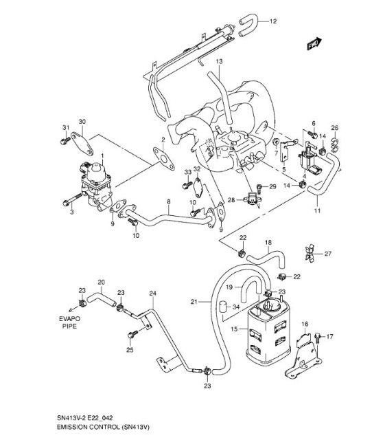

I replaced the little valve on the rocker cover already, are there any other components to the system that could get clogged? Also if there's no egr, what's the little pipe that connects to the last exhaust runner, the one on the cabin side of the engine?

#1 is the EGR valve on a M13a engine in a Jimny - IF FITTED - not all markets have them, you need to "eye-ball" your car to see if it's fitted, and that little pipe that you describe on the #4 cylinder exhaust runner suggests that your car does have it.
Look at the intake manifold see if you find the #8 pipe and follow it back behind the head.

20 Apr 2024 15:47 #255697
Replied by yakuza on topic Does the M13A jimny have an EGR system?
Assumption is the Mother of all messups.
And I assumed since there is no exhaust connected there, that it was not an EGR.
